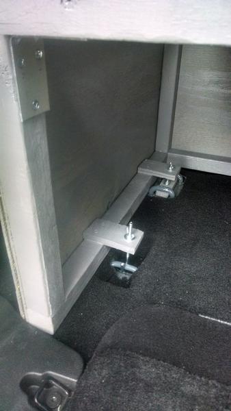

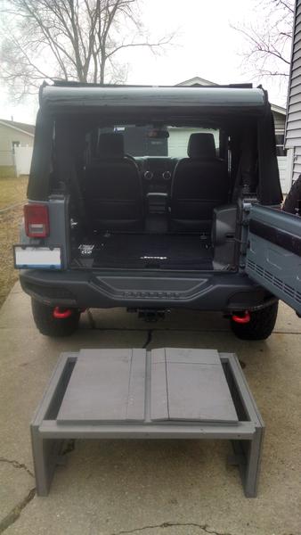

Alrighty then,
My option is a center frame to hold up the deck. The deck folds in two places, first to make it easier to load, and second to create clearance for the soft top to fold down. The frame ties down at the rear seat brackets and the center section is secure from access anywhere but through the tailgate.
The box is placed in through the back and then attached to the seat brackets
The inner sections are folded out and bolted down, here you can see the clearance the outer sections provide for the top
The rear deck is bolted on and the deck is complete

Now I feel like an idiot! I posted pictures, but had the gallery setting on private. Hopefully they show up now, let me know if you need anything else
