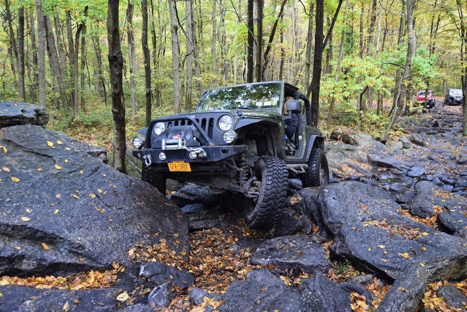

Been on the stock wheel with 37's and 1.5" spaces for about a year without any issues
