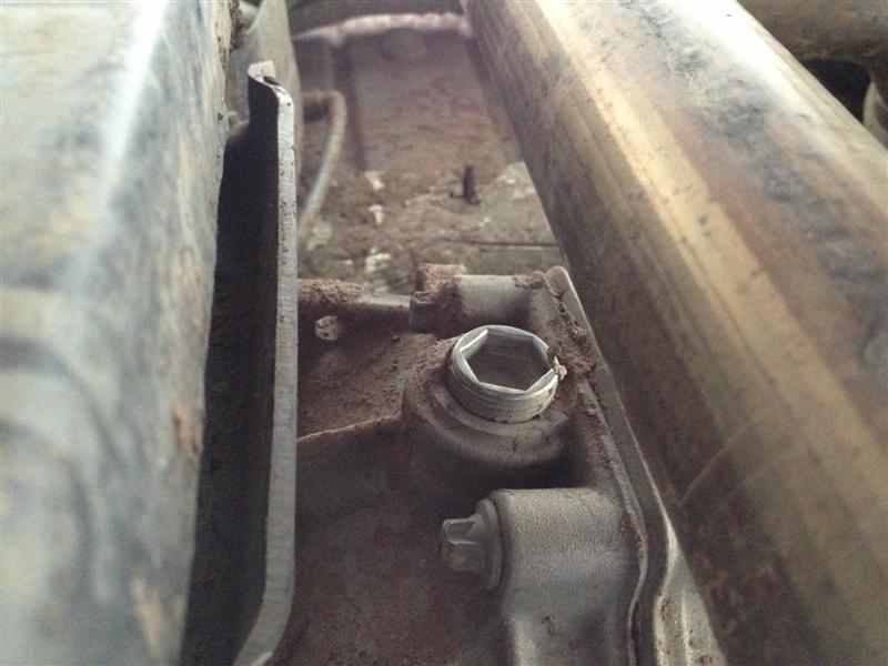

Unable to find one short enough to fit between the drain and the exhaust on a 2012 Rubi I made two - each were less than $3.
The problem is the space between the drain and the pipe - about 1.5"

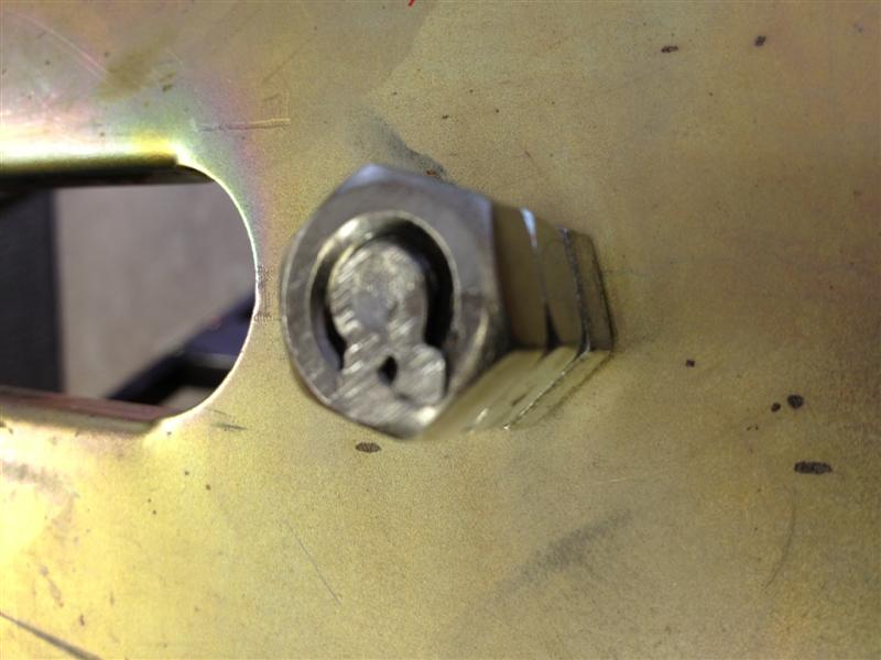

I purchased 2 bolts 4 nuts from Home Depot - all with 17MM heads

Got them to line up and tacked them
Name:	ShortSide (Medium).jpg

The shorter stack works best ...
