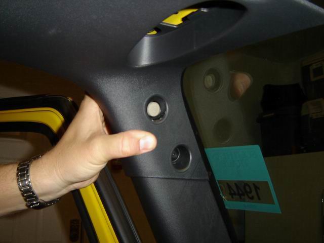

I noticed my opener button was the exact same size as the screw hole on the windshield trim, so....

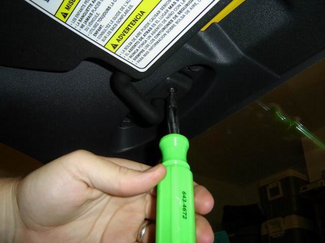

-I removed the sunvisor with a T20 screwdriver ( I could not get the entire trim off, so I just pulled back on it)
-Added Velcro to front side of Garage Door Opener and back side of trim, just below the top bolt hole.
-Positioned Opener & re-installed trim/visor.
I hope these pics are attached correctly.
With the high position mount there are no problems with transmitter distance.
Changing the battery will be a pain.
