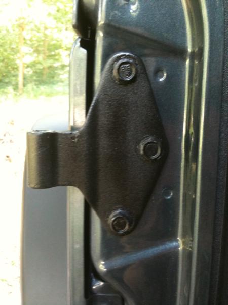

just do 1 hinge at a time. When I did mine, I sanded them down, I'd 2 coats of primer an then bed lined them. I did the fronts an the backs of them. Trust me, you won't have any problem re- aligning the hinges because a soon as you get the hinge off there is no paint under neath the hinge. just take your time and let everything dry before you put them back on. good luck! here's a pic of mine.

how hard was it to realign your door? wanna do this but dont wanna mess around for half a day trying to get my doors to close properly

I havent bedlined my hinges yet, but I have had to removed the hinges in order to get them loose from the door (2007 with doors never have been taken off prior to me owning) because they were practically rusted together.
I am just restating what others have said. It was a piece of cake to re-align the hinges, as it was missing paint underneath it, as well as dirt/grime underneath. I lined it up, ran the bolts in, and the door shuts perfect.
It is not something I would worry about. You could even outline the hinge with a pencil, then rub the pencil mark off after attaching it.
