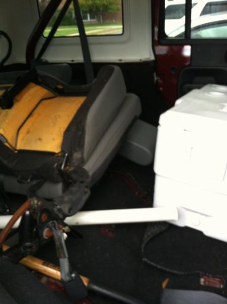

This is the back area with seats in it still. Tonight after work I'll start getting materials and maybe start building some of the boxes/frames. With the locations of some of the bolt holes and welded bolts from the seats, i think I'll be able to find a way to use these to secure the boxes to the floor, preventing movement and/or rattling.
Any thoughts on what material to use? I'm thinking 3/4 plywood boxes/drawers. I'm not sure if I'd need to reinforce these or not since we will be sleeping (and more than sleeping ), depends on how I construct them I suppose.
