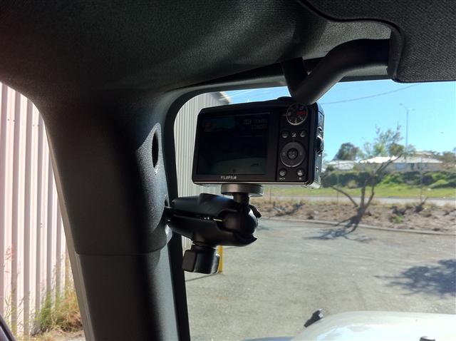

I decided to come up with a mount for the centre of the sound bar so I put a metal strip along the top of the camera and a powerful Krussell magnet was glued to the soundbar. Works a treat and the video doesn't have to be flipped 180 either..
Well, finally solved this problem. The only problem with the magnet mount was the fact that it only worked in that one spot and that the vehicle vibration would alter the orientation slightly. Today I had a quick look round Maplins and found this:
The clamp jaws are seriously strong and open far wider than initially thought. It allows me to securely mount the camera in various different places around the Jeep including the roll bar, even with the padding in place. Works on the plastic side pillars either side of the windscreen and on the soundbar. Darn useful and less than a tenner to boot!!
