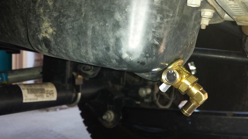

For the past year I’ve had difficulty doing oil changes because my drain hole on my 2012 JKUR didn’t line up with the hole on the Rock Hard skid plate. It was aimed at the side of the skid plate hole. I could either try and deflect the draining oil into the catch basin and make a big mess or remove the skid plate. After a few oil changes of removing the skid plate I was tipped off to Fumoto oil drain valves, Fumoto Valve | Qwik Valve™. They have several options of oil drain valves for lots of vehicles. There is also an easy make, model, year search feature.
I went with a 90 deg elbow option ($29.95) and I’m able to rotate the elbow to about a 4 o’clock position. I also ordered a 3’ piece of 3/8” ID tubing ($3) and a 5/8” spring clip ($1). The tubing allows me to direct the oil flow by attaching it to the 90 deg elbow. I’ll be able to drain directly into the 5qt & 1qt bottles that I saved from the previous oil change.
No mess from dripping oil pans.
No mess from pouring the used oil into plastic bottles to transport to recycling center.
No more dropping the skid plate every oil change.
Here are a few photos before and after the skid plate was installed. I have 5/8’ between the skid plate and the bottom of the elbow on the drain valve.

I did have to trim the deflector ring that was on the skid plate for added clearance.
