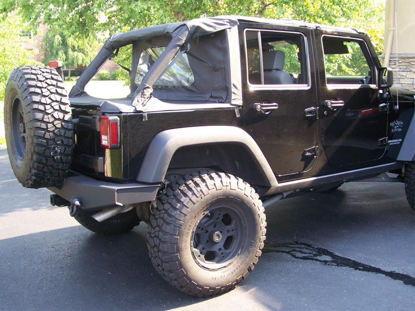

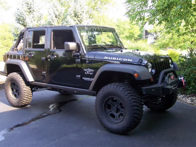

I really didn't like raising and lowering the soft-top and there was no way to cover things in the back when it was down. I wanted to install and leave the "Duster" on all the time and just add a "bikini" and "windjammer" on rainy, or really hot days. I couldn't find one to purchase for the Unlimited, but read on the forum where a few others had done something like this.
I took wrap-around Windjamer as sold for the two-door JK, a Safari Bikini, and Duster to my local upholstery shop, and he:
- Removed the "J" channel from the top and replaced the zipper at the bottom with it. (This give me a nice solid "water tight" seal all the way across)
- Added 1 1/2" to each side just behind the door surround to allow room for the seats to go back.
- Added 2" to the top and installed snaps to fasten the Windjammer to the roll bar.
- He then added two small "flaps" to the back corners of the "Safari Bikini" to cover the little openings, and installed snaps to hold these down.
I have had it out in the rain, and so far almost no leakage. I had a few drops come in where the header meets the windshield, but just added some weather-stripping and will see if that fixes things.
I have taken my soft-top to the basement for long-term storage, and plan to run this top set up until late fall when the hard-top comes out.
I love the fact that the two pieces will fold up and lay in the back, ready to be installed at a moments notice, but completely hidden.

I HAVE BEEN RUNNING MY LIKE THIS FOR ABOUT A YEAR.... IN A LIGHT RAIN ITS OK BUT ANYTHING OTHER THAN A SPRINKLE MY LEAKS LIKE THE TITANIC......
