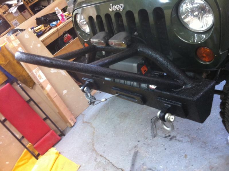

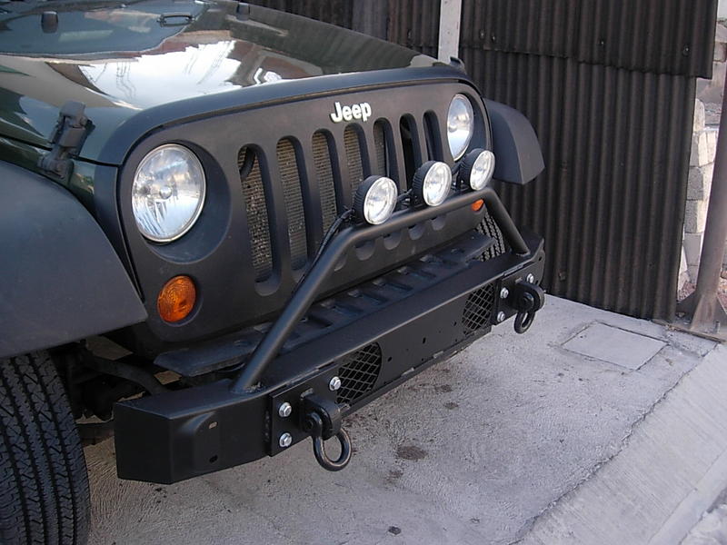

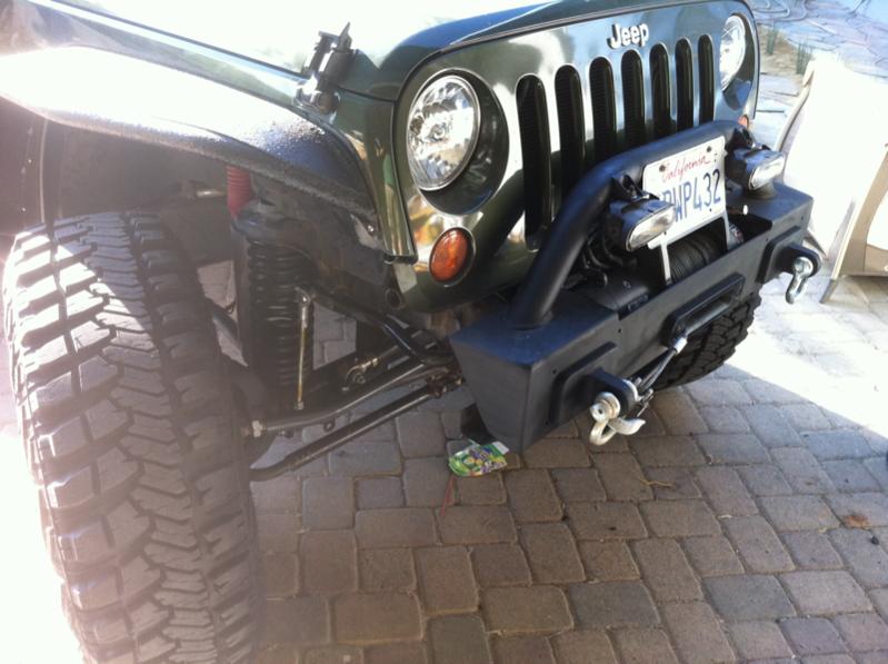

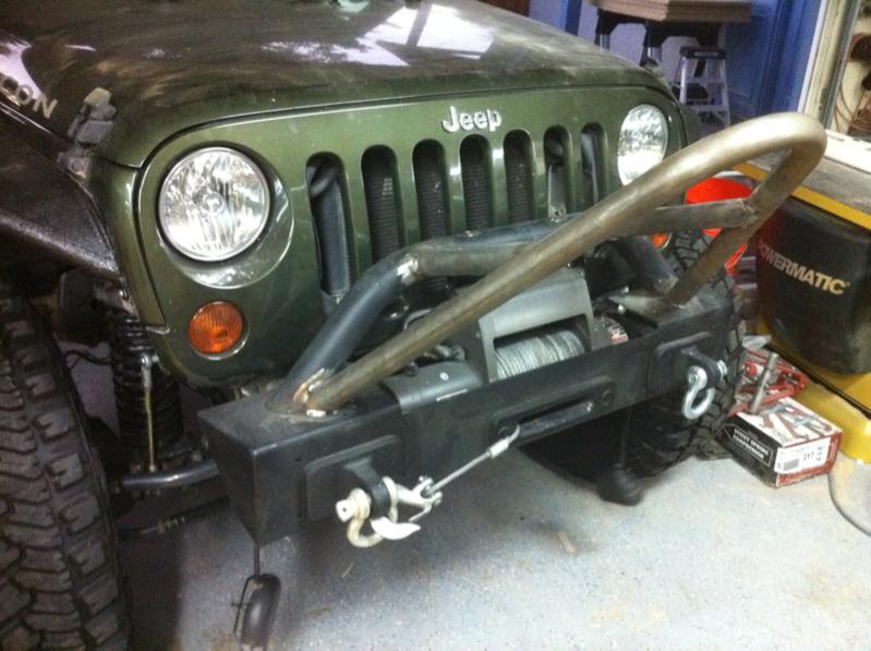

This is what I did to my stock Mopar bumper. Teraflex D ring mounts.

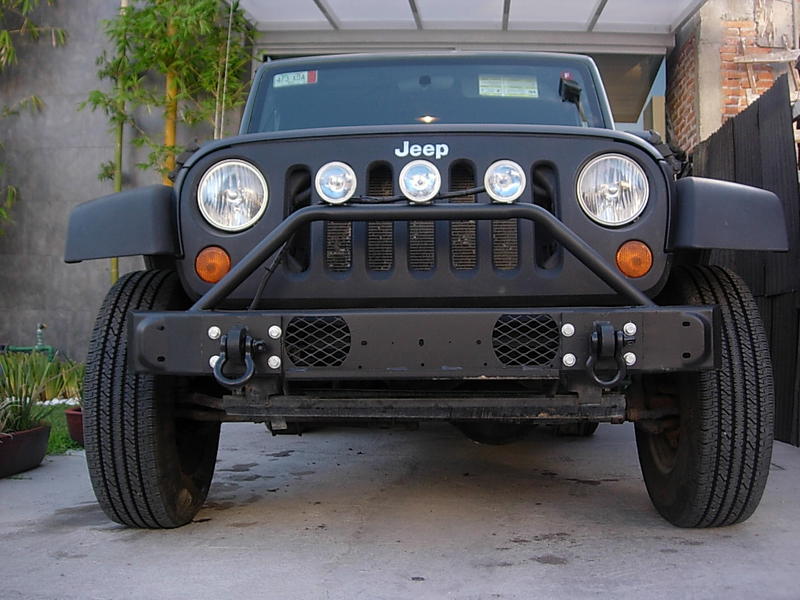

This is what i did, you must remove the plastic crap.Click image for larger version

So it seems the D-rings are still mounted to the bumper...so I'm guessing it is strong enough for being a tow point?
Old Aug 6, 2011 | 06:27 AM
ronjenx's Avatar
Posts: 12,907
Likes: 185
From: Maine
It looks to me like the d-ring pads are mounted to the frame, and the bumper is sandwiched between the d-ring pad and the frame.
Bumper strength isn't a factor.
