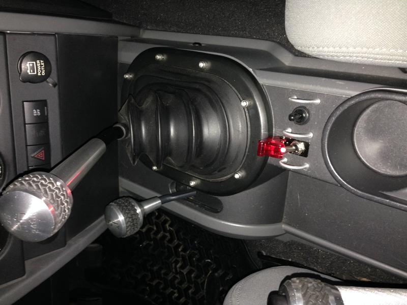

Good write up! This what I did in mind! Another alternative position for the switch.Click image for larger version

Originally Posted by runit3
I know it's a fairly dumb question but in the insane chance someone is pressing out on the remote while you are flipping the in, in the cab, what happens?
That's why you wire a separate on/off switch that only allows the in/out switch to work. Flip the winch switch first, then toggle the winch controls.
Originally Posted by RDakota
Instead of a switch to allow the in-cab use of the winch controls, replace it with a switch that switches between the outside winch controls and the inside winch controls? That way there is no interference.
That wouldn't make sense. The "outside" winch controls are generally on a wired remote that plugs into the winch body.
