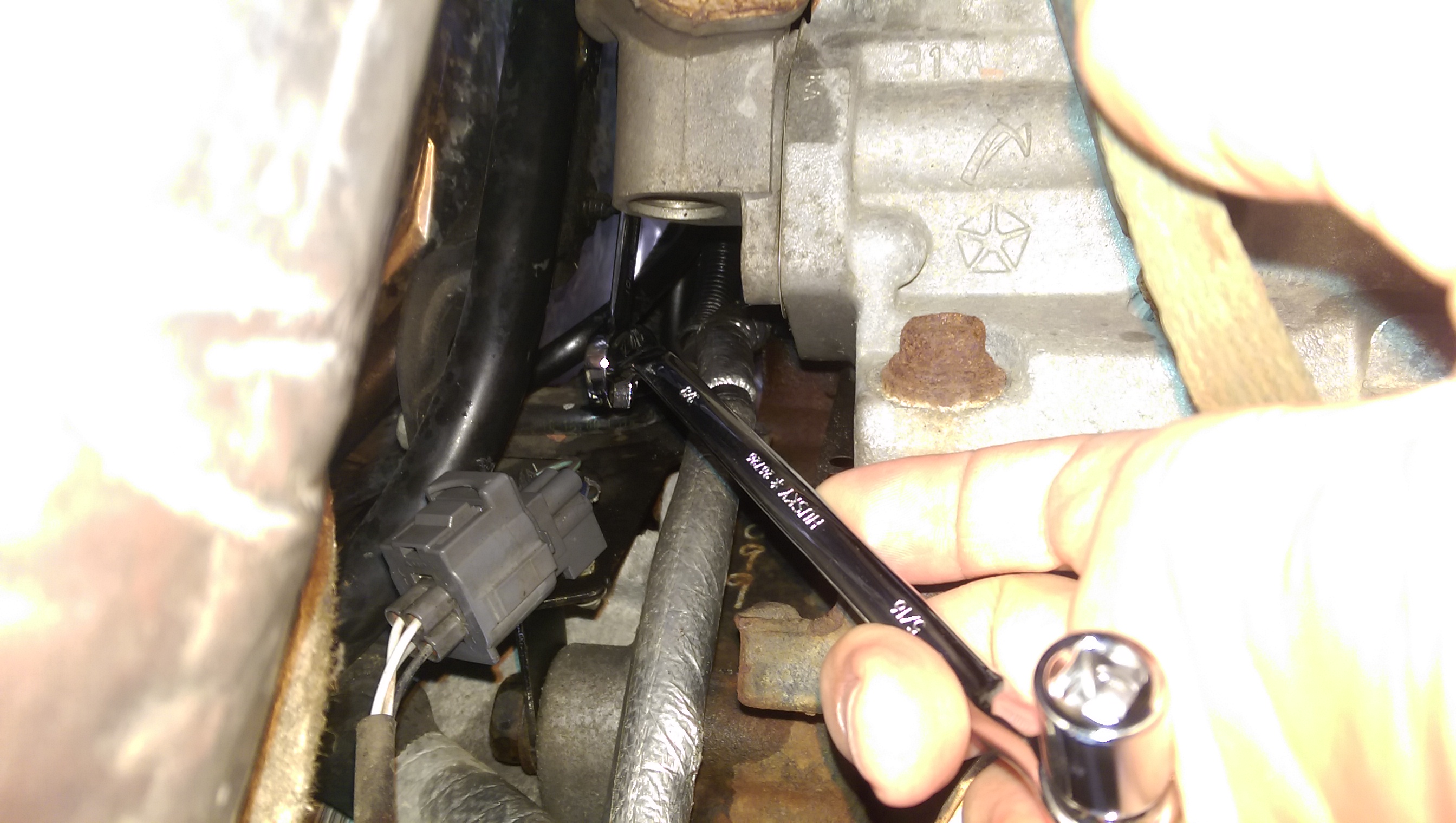

Did this job today on my 2010 JK with Auto transmission.
There is lots of good info in the thread in addition to a good write up in the original post.
I was able to get to the trouble-bolt in less than 10 minutes and without manipulating the transmission dip stick tube. Here is how I did it.

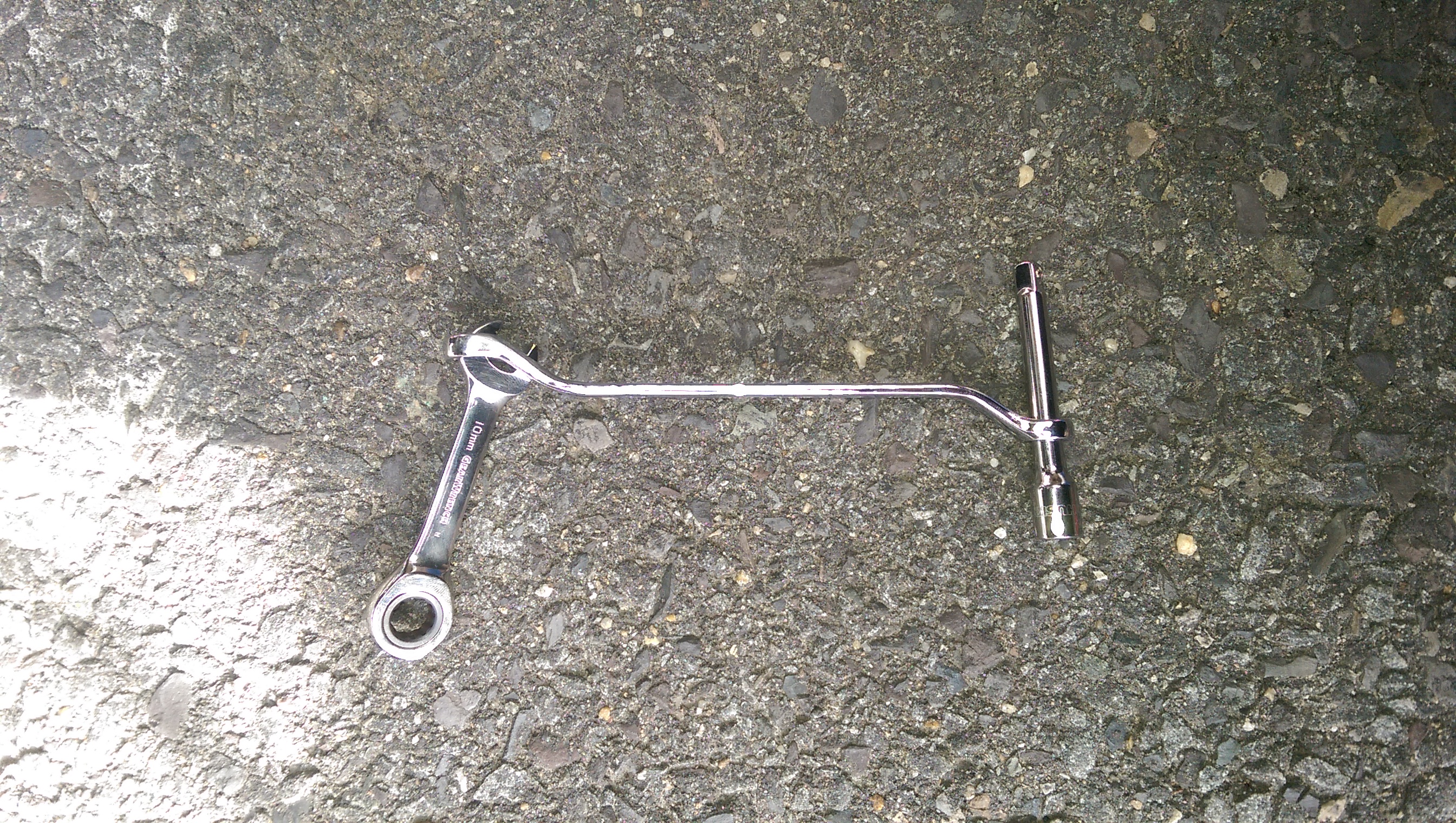

Ordered this Combo Ratchet Wrench from Amazon:
http://www.amazon.com/gp/product/B00...ilpage_o06_s04
The short length gives you more freedom of movement in getting to the bolt. However, it is still on very tight. I hit it with WD40 a few times to loosen anything up. I also saw a tip about moving the EGR valve back and forth to loosen it up. I didn't try that.
I placed the ratchet end of the combo wrench on the bolt. Then placed another box-end wrench over the back prong of the other end of the combo wrench. Then I slid a ratchet extension into the other end of the box-end wrench and pulled on it.
I was surprised it didn't break the ratchet mechanism of the combo wrench, but I was willing to take that chance. Here is a picture of the whole contraption outside the vehicle.
Using this, I had the bolt out in a few minutes. I switched from using the ratchet end to using the open end when it looked like I would have trouble getting the ratchet off of the bolt due to the dip stick tube.
I also took the whole fender off rather than just the liner. Not sure how much this helped, but there was definitely lots of space.
Hope this helps someone out there.
