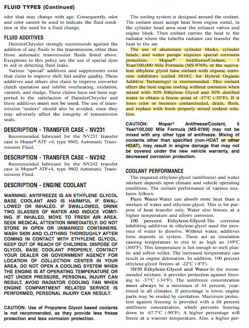

I noticed the other day at 16,000 miles my engine coolant reservoir showed below the min. I went to the jeep dealership and bought the antifreeze/engine coolant. The guy said I didn't need to use 50% water and 50% antifreeze. However, all of the forums I found and websites say to use a 50/50 ratio. Thoughts?

If your bottle says coolant then yes, mix it 50/50 when you add it in (distilled water obviously).

I did not see a pre mix at the dealer either, had to mix myself....you can adjust your ratio if needed..... 60 coolant / 50 water for areas that require that. I did 50/50 myself
Most important is to use the correct coolant type for your year!!!!!!

One fellow I know through work is up in the High Arctic he was telling me a few tricks used up there to keep things from freezing.
Just tweaking the ratio a bit helps particularly one the nights you have to park outside.
