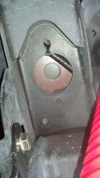

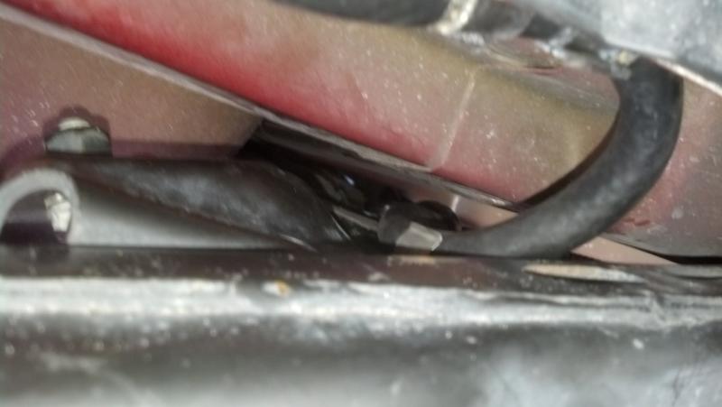

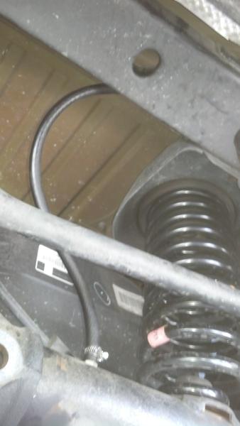

I started with the rear. Removed old hose by unplugging from the axle then sliding the capped end of the hose (in fender) off the plastic screw. If you wiggle it, it will come off. Find where the metal clip attaches to the frame. You will want to clip the new hose in the same place. Then pull the hose out from under the fender so the metal clip stays on it. I transferred the metal clip to the new hose but since my Jeep is raised 4" I added 4" from the clip to the axle end of the hose. Next I un-taped the plastic holder at the cap end and reattached it with the same tape to the new hose the same distance from the metal clip as the old one. Re-clip the hose where it was and extend it into the passenger side tail light like Rooster showed above.

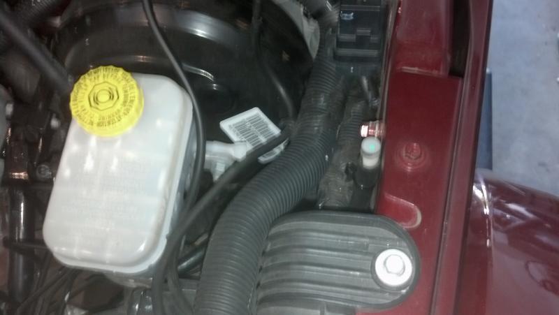

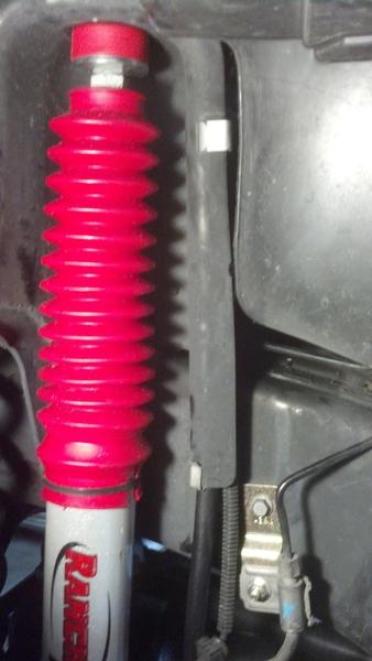

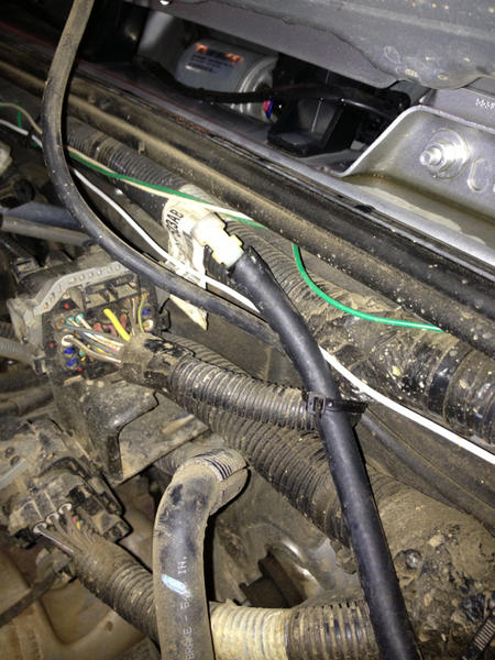

Moving to the front... Once again, note where the two (2) existing metal clips are. They will be used on the new hose. I added 3" from the lower clip to the axle end for my added travel.
I routed the hose under the brake lines and electrical bundles over to the top of the fender. I could have gone to the firewall but I didn't want anything near the steering shaft.
(breather cap is white with green dot)
