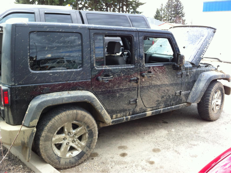

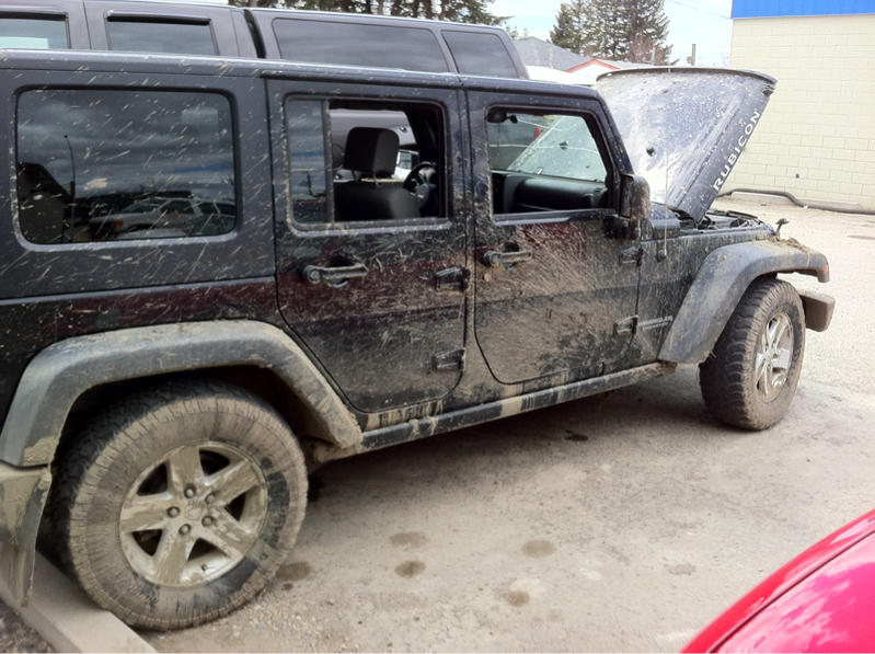

Any one run their lines inside the cab? You can see from the water line I'm a little worried that behind the tail light might not be high enough. I was thinking of bringing my rear breather into the roll bar. The front, t-case, and transmission I thought behind the dash or up the pillar. Worth it or waste of effort?
The pic is pre-snorkel and I'm afraid I might get really brave once it's installed.
Little tip if you like to play submarine in your jeep remove the foam insulation under the hood. My fan splashed it until lit was soaked which shorted my battery. Amphibious winch would have been nice too... Green dash LED's turned brown and jeep was dead in the water. (Literally) even with key removed and lights off there was a weird brown glow from the dash.
