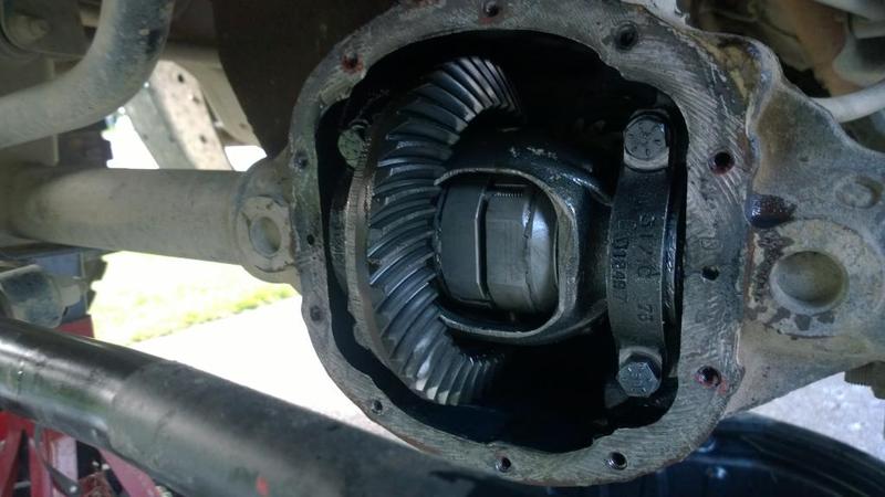

I just finished the installation of a front auto-locker in my Sahara D30. The brand was a Lokka but the installation would be similar for any auto locker. I won't bore you with the tire and axle removals. Did the U-joints at the same time.

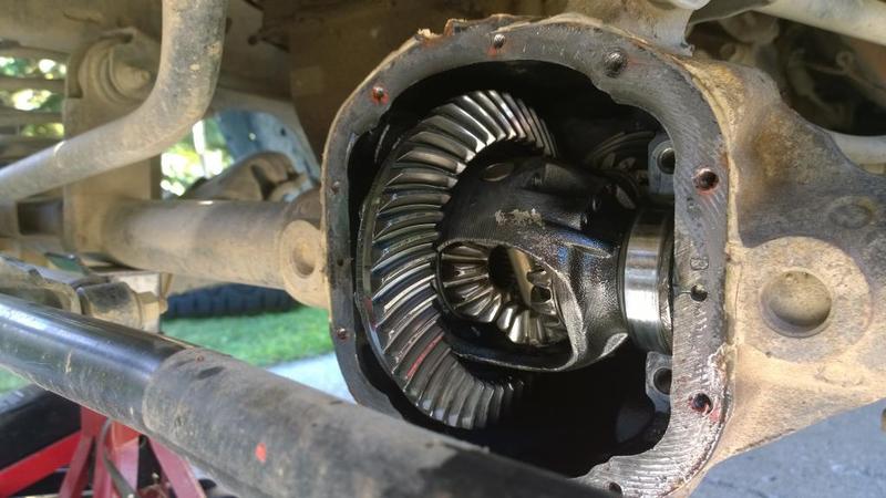

Here it is with the diff cover removed and bearing caps neatly placed on a piece of cardboard so I would remember which one went where.

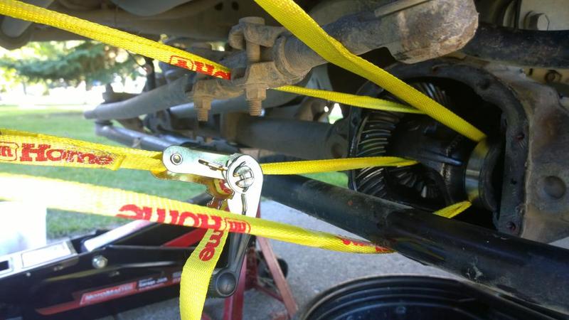

The pry bar trick did not work for removing the carrier. The thrust washers were in TIGHT! Thankfully two ratchets straps hooked up to the front bumper were able to pull it out. Ratchet straps, is there anything they cannot do?

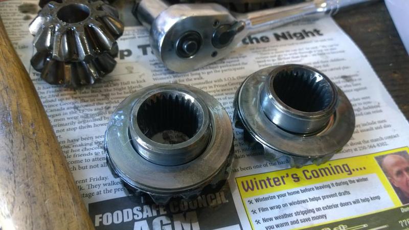

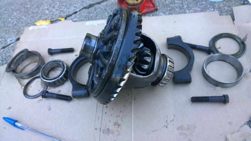

Here is the carrier and all the bits and pieces laid out.

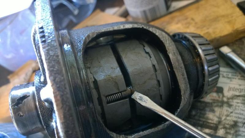

Followed the manufacturer's instructions for assembly of the locker in the carrier.
Darned springs - at least I did not lose any!

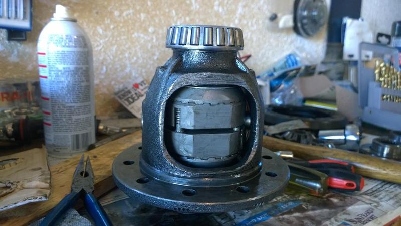

getting close - I could smell success!
And there it is! I won't bore you with filling it with diff oil etc. and replacing axles and brakes and wheels.
First impressions - in 2wd, very little noice, a bit tighter steering (wants to go straight). Can't wait to get it offroad to really test it out!

Did you just put everything back the way it was? It went back easily?
Old Oct 9, 2014 | 10:03 PM
PG-JKU's Avatar
Joined: Oct 2009
Posts: 1,605
From: 54° 4.5' N 123° 7' W
I had to tap in the carrier and thrust washers since I didn't have a case spreader. Otherwise it was fine. I made sure that the bearing caps were the same side and direction that I took them off.
