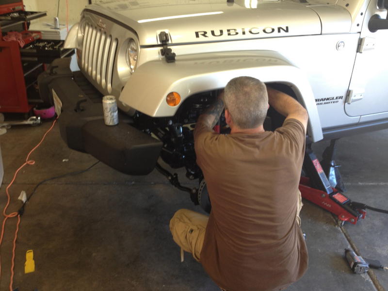

Unpackaged my kit... felt like a kid in the candy store.. Loving the beefy components. Looking at all the parts scattered on the floor, start to feel that overwhelming feeling. My buddy Brent just as excited came over to help me out. We started to tear down the front end...

After getting everything situated and the wheels off... time for a beer break? .. NOPE.. keep going :-)
Pulling off the control arms, shocks, springs was a piece of cake. So while I was working on that.. Brent started pulling the bumpers off, since those were going to be replaced. My confidence is high!

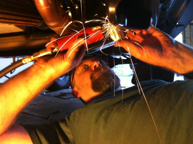

So with this done.. I started on removal of the driver side lower control arm bracket. after about an hour of trying to get through it.. I gave up for the night.

I got a late start... damn day job. Kept at grinding and cutting away. I finally decided to grab my friends reciprocating saw. man oh man.. it cut like butter.. but did not allow me to get into the tight spots very well. So i cut most of it off, and then back to the grinder.

after all that grinding and cutting, I got 90% of the brackets (upper and lower on both sides) done. I had to call it a night. spirits are dwindling for Mondays trip... I have people driving from MN and WI for this trip. sigh
