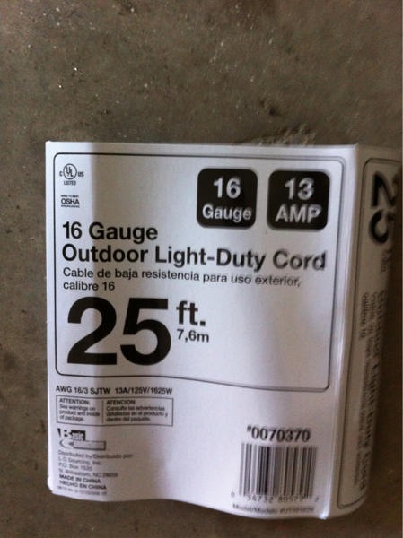

What you will need:
1) 15-25 foot outdoor extension cord with ground (3 prong)
2) stripper tool

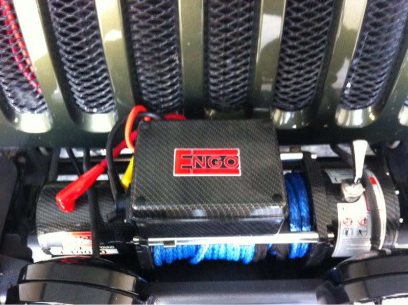

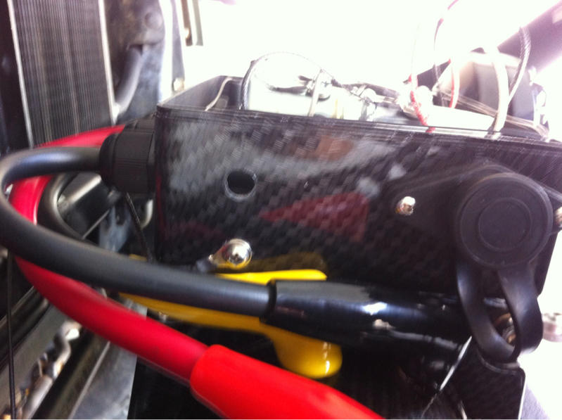

First, cut the ends off of your extension cord and run your wiring. Once you have your path, drill a 3/8" hole in your winch's control box to run the cord through.

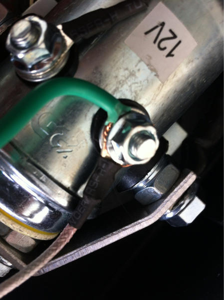

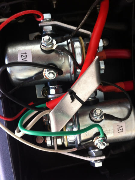

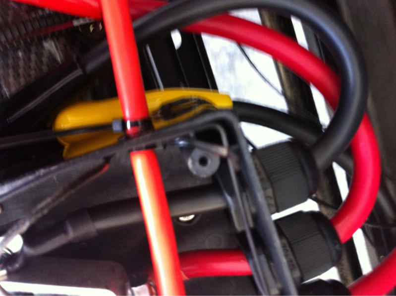

Next, splice your wires to your winch's control box using the screws on the motors. You will have 3 wires: Power, in & out. With the ENGO winches, you do not have to splice in the wiring as there is post with screws on the motors. See below:

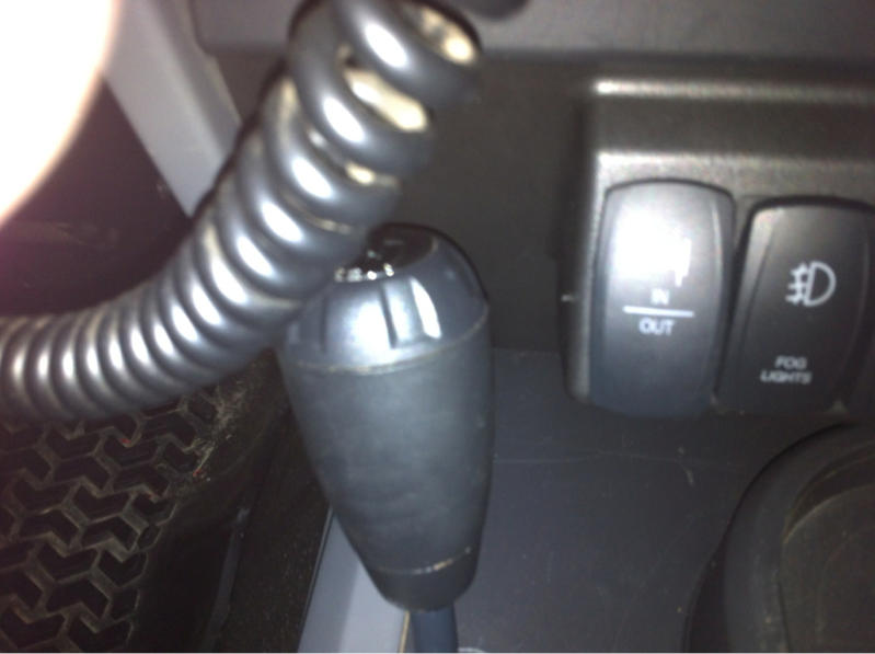

Then all you need to do is wire to your rocker switch and your done! Super simple and cost about $20.
