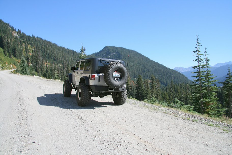

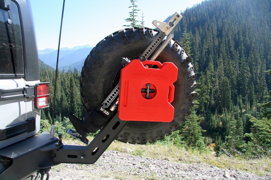

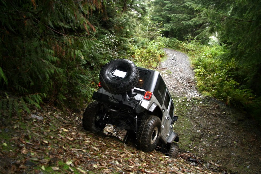

Here you go!
Hanging on it!

I'm trying to figure out how a hitch would work with that, at least one like the stock hitch. The bolts go right where the winch is, so can't figure that one out. I can see how an aftermarket one that mounts to the frame would work provided it stays under the bumper, but that looks like it might need to be custom made.
