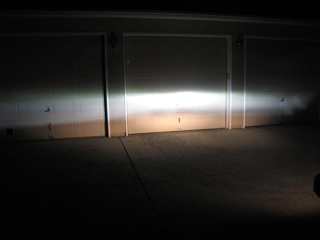

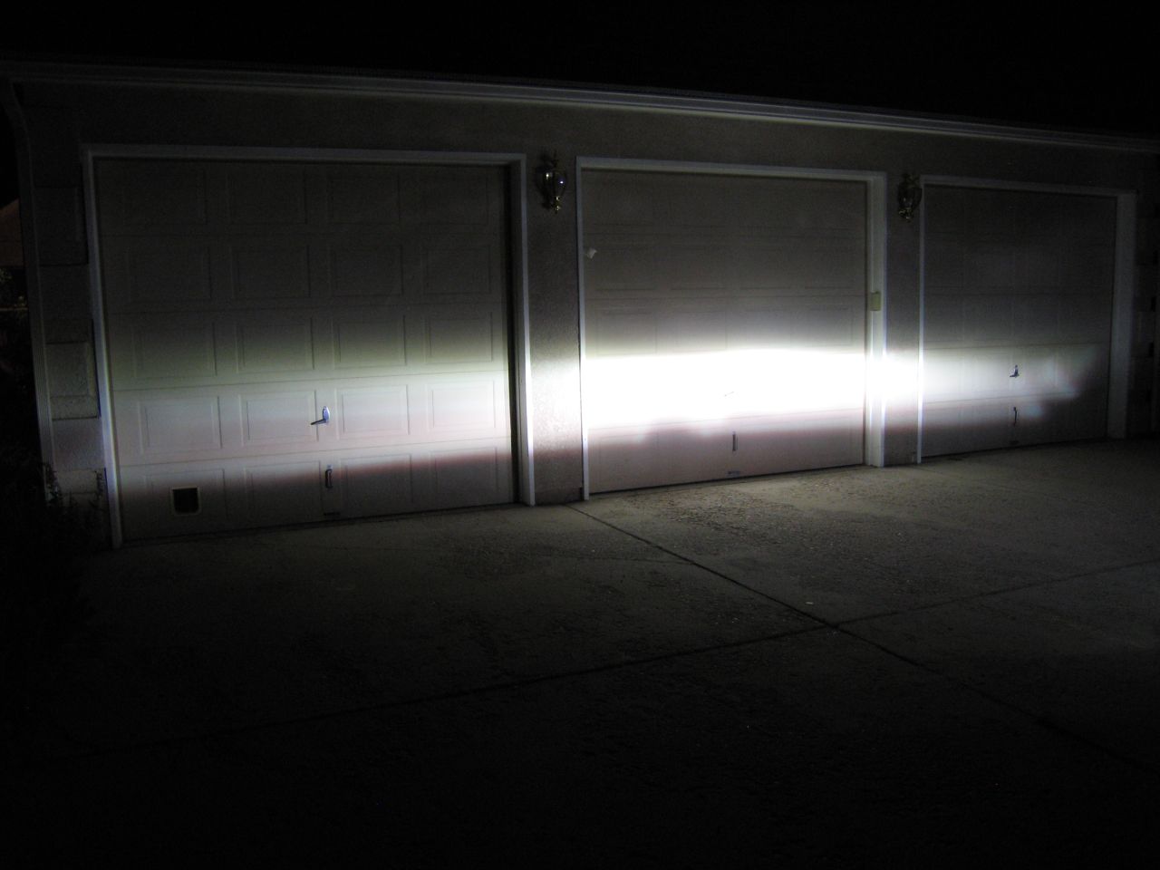

14. Test to make sure the headlights work correctly, engine off and on, and high/low beams.

17. Enjoy your dramatically brighter headlights.
I think that's about it. Please let me know if there are any errors so that I can correct them, and any suggestions are appreciated as well.
The pictures are of the horn, the power steering reservoir, where the airbox base goes, and where I put the relay control module.

Here's some pictures of the HIDs. The garage doors are about 15 to 20 feet away from the Jeep. The pattern is very wide, but the cutoff is pretty sharp on the top and bottom. These are all pictures with the low beams. I didn't think to take any high beam pictures. I'll try to do so later.
HID low beams only
HID low beams and stock fog lights
HID low beams only
HID low beams only
HID low beams only
