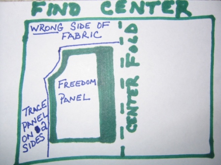

You want to lay your panel on the fabric just as shown in the picture.
You need to make the right side of the panel flush with the "fold/center" of the fabric. And trace the outline on the two sides of the panel. The bottom edge will be your open end and will get hemmed and velcro sewn to it.

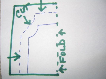

Using a ruler, add 2 inches all the way around your inital tracing of your panel.
This will allow you seam allowance plus a little extra.

Now fold your fabric in half and cut it out. DO NOT CUT FOLD.
The fold is where all the weight will be when your bag is carried.
You want it to remain the "fold". No seam to worry about ripping through.
