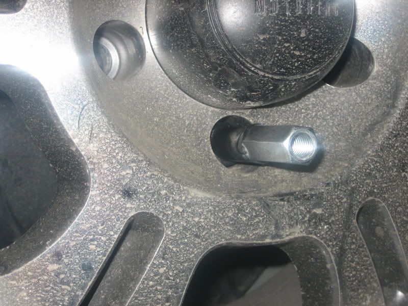

Well, i broke my stock bracket, and didn't want to spend the money to buy a new one so here is what i did with stuff i had laying around.

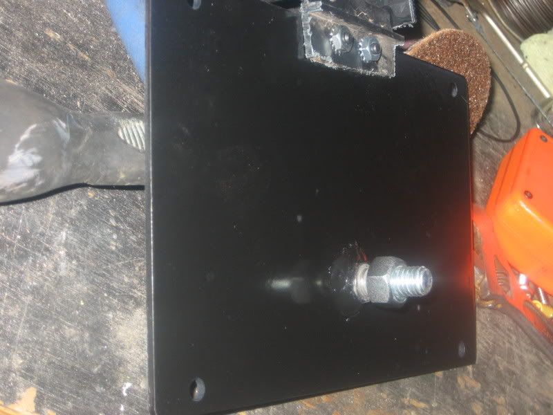

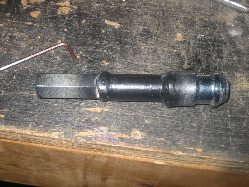

I wanted to make sure it didn't make changing a tire any harder so i started with an old lug nut welded a piece of pipe to it and then a nut to the other side of the pipe,I cut a piece of sheet metal down to fit my license plate on, and welded a bolt to the back of the plate.in order to keep my license plate level when it is mounted i added a jam nut to hold it in place.

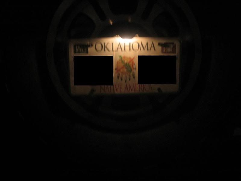

i pulled some info from another thread for the lighting and just cut my stock light out glued the top on it and wired it to my new bracket.

Lug nut with pipe and nut welded
Plate with bolt weled to it (i also drilled the holes on the top to mount my light.

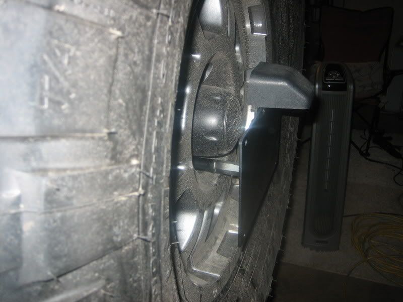

Lug nut tightened on spare

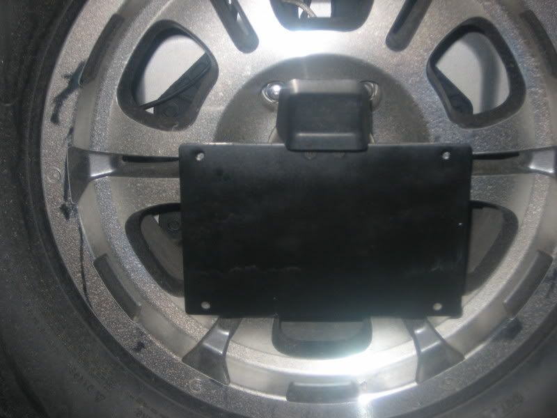

then plate added to it

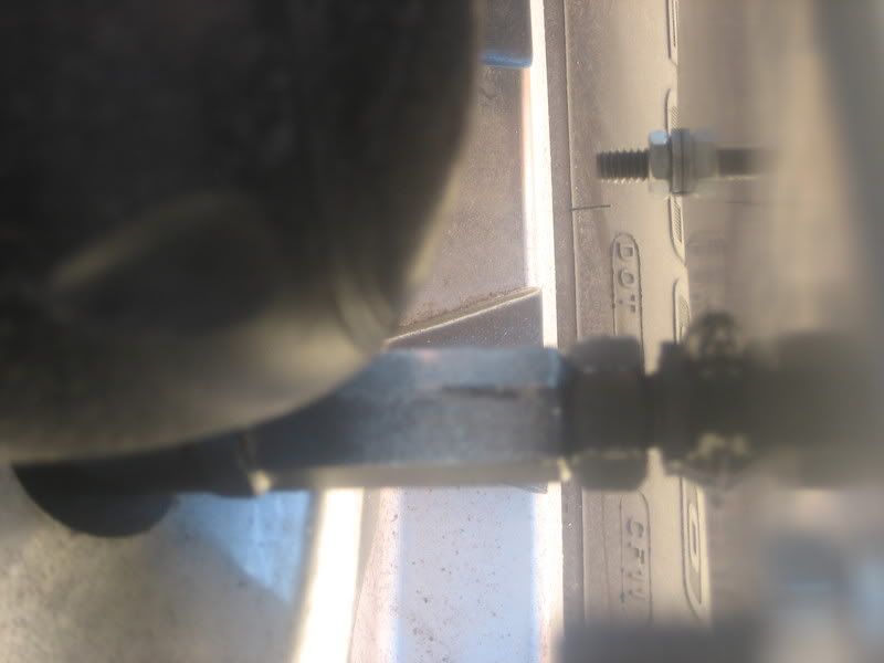

here you can kinda see the jam nut to make sure the license plate is level

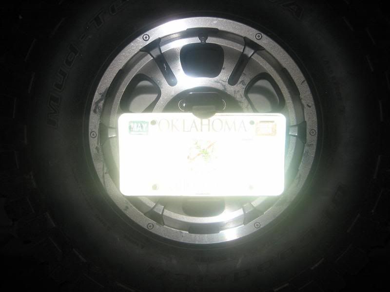

then a couple of pics after it is done
