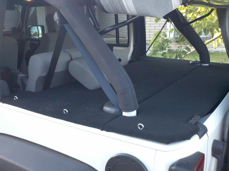

Old Aug 1, 2011 | 05:32 AM
  #184
jsmit450's Avatar
Posts: 31
From: Bristow, va
Default Deck Lid Mod Done
I got my project done yesterday and looks awesome, thanks for all the great ideas
