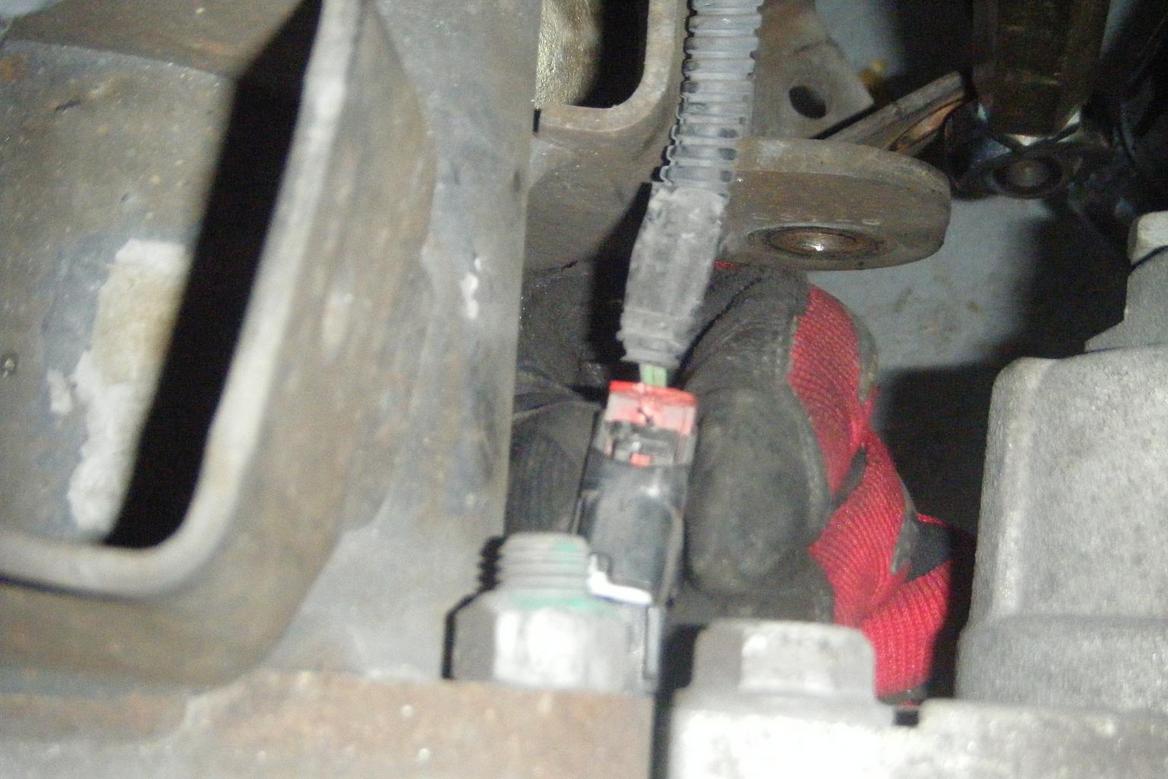

3. Disconnect ABS lines, they are hidden behind the shock tower and have the same type of locking red clip on them. The best thing to do is to first push out the 2 christmas tree clips that are located on the shock tower, you can see them here.
Once you push them out, give your line alot of slack and reach up and pull the connectors out, slide back the red lock and they should pull apart.

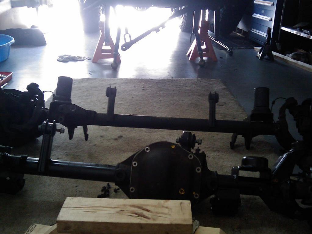

10. At this point your dead axle should be completely disconnected, this is where the most difficult part of the installation came. Before you start, take a break and smile to yourself when you compare the old to new axles!
11. If your working by yourself (like me), the front axle is extremely heavy for one person. Slowly work it up to your Jeep and connect the upper control arm bolts first. Do not tighten down bolts yet.
12. Then slide some wood blocks under the brakes to help get the axle high enough to stick a jack under it. Once your jack is underneath you should be able to connect the lower control arms, while you're connecting the lowers try to get your springs to slide in at the same time. Do not tighten bolts down yet.
