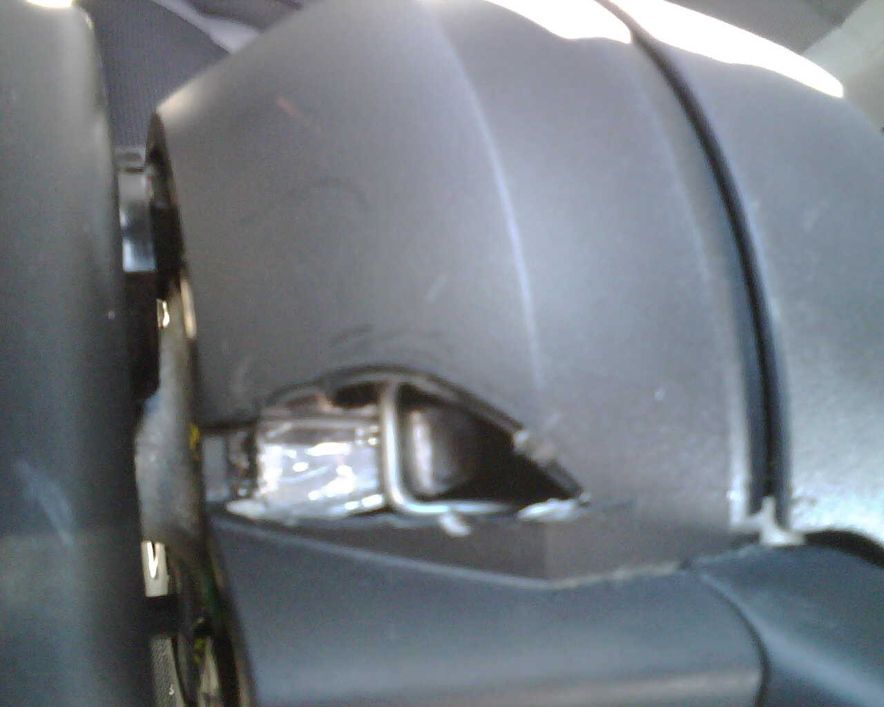

Just installed last weekend, and couldn't have done it without this thread! To help others who were stuck at step 1 - removing airbag behind the Jeep symbol on the steering wheel - here are some pics
Cutting away the shroud to find the clips (that were not where I expected them to be). The push twist wasn't enough with my stubby screwdriver - I had to push then flick them off

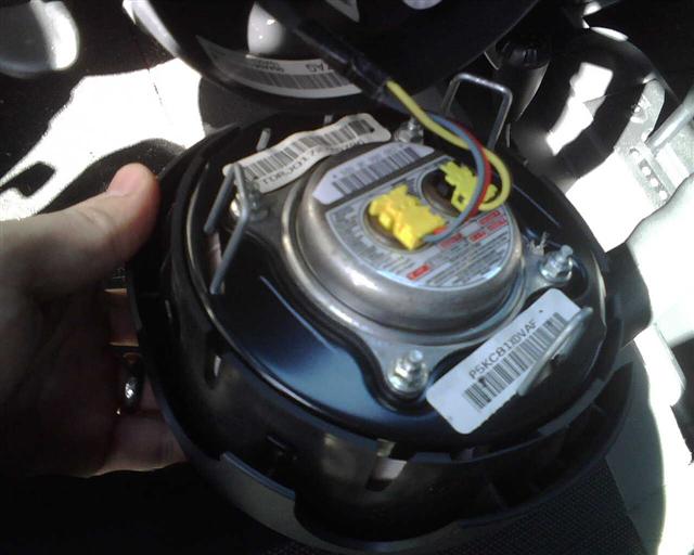

The airbag, the three clips now removed. I remove the yellow and black connectors by carefully pinching the sides and pulling them out - AFTER THE BATTERY HAD BEEN DISCONNECTED. Disconnect before removing the steering wheel - I pulled too hard and broke the wiring harness.
