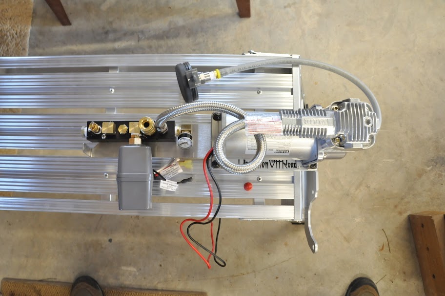

Step 3
Find a good location (i.e. workbench or other flat surface) where you can spread out the kit to complete the pre-install phase.
This step is very self-explanatory (especially after watching the videos). Here is a picture of how I built my setup.

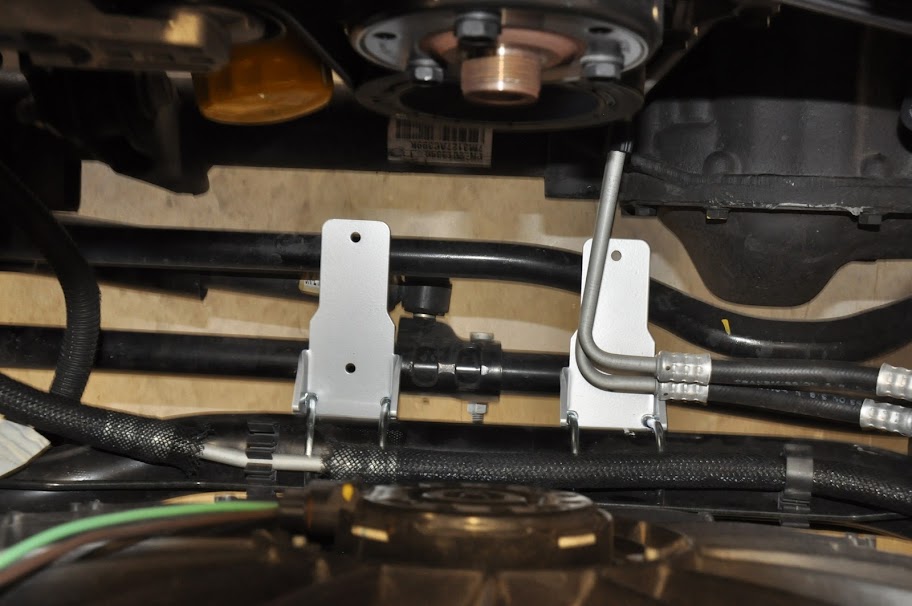

Step 5
Install the tank brackets. Note the automatic transmission cooler lines will be moved later in the install.

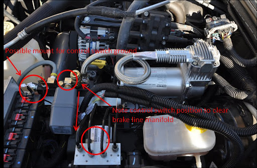

Install the completed compressor kit onto the brake manifold. Note to keep pressure on the brake manifold bolts once you loosen the nuts as I've "heard" you can cause some vacuum issues if the seal is broken. I'm not 100% certain about this, so any brake guys please speak up and I'll adjust the write-up accordingly.
Once installed, the kit should like very similar to this, with the exception of your personal preference for plugs or add-ons to the distribution manifold. Note the location required for the pressure switch (to clear brake line manifold) and a possible location for the ground.

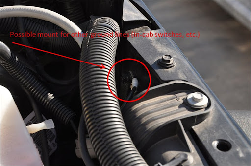

Step 7
Here is another possible location for additional grounds (e.g. in-cab on/off switch).

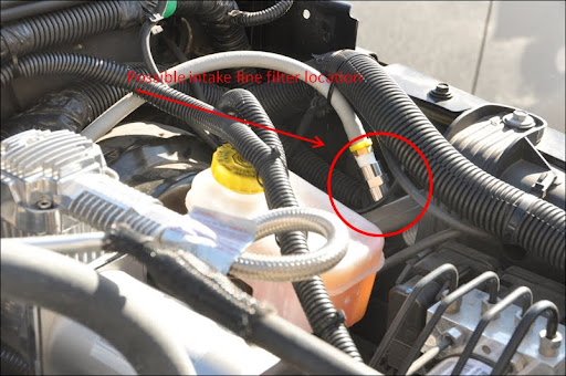

Step 8
I believe you'll want to use the extension hose for your intake filter as the compressor's rear is very tight (insert joke here) as it doesn't readily provide any access space to change it out. I installed mine in this location.

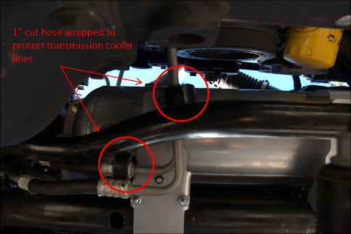

Step 10
Move the transmission cooler lines below the brackets and wrap them with tape or hose. I cut and used 1" hose and then wrapped with tape to keep them on.
