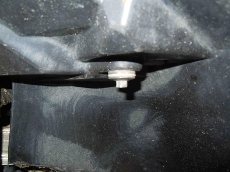

2nd step, Grab yourself four metal washers that fit the screw, also get two rubber washers.
3rd step, install two metal washers and one rubber washer per side. (use lock tight-- dam bolts come loose every 4x4 trip...)

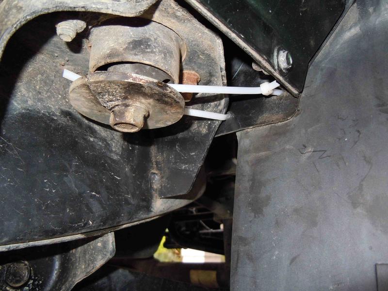

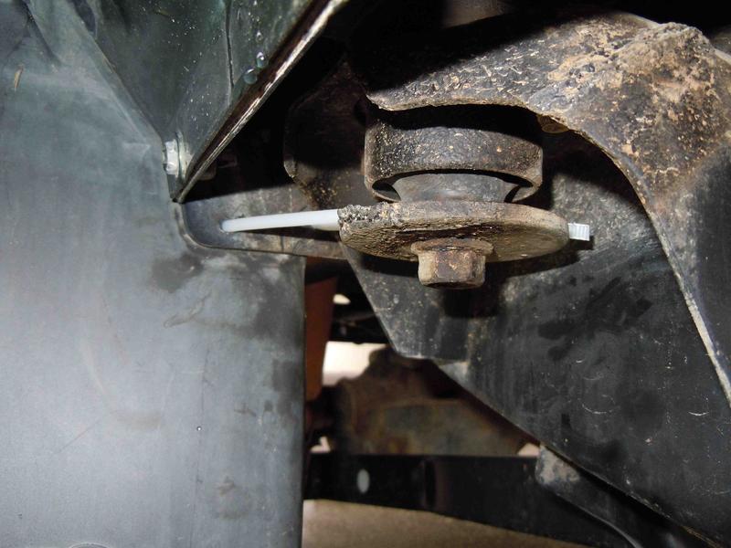

5th step, drill two holes towards the bottom of both your front fenders
6th step, Feed the zap-strap through the holes and attach around the body mount and tighten!
