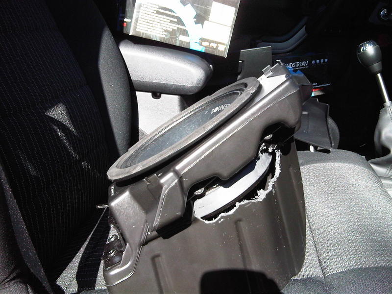

Old Feb 5, 2012 | 11:42 AM
ted2012's Avatar
Posts: 10
From: NY
damn...is it that big of a deal if the box was tampered with im not tryin to be in no competitions, i just installed 6.5" speakers in the front but the magnet was so big didnt go in all the way so had to modify it like this.....Click image for larger version
