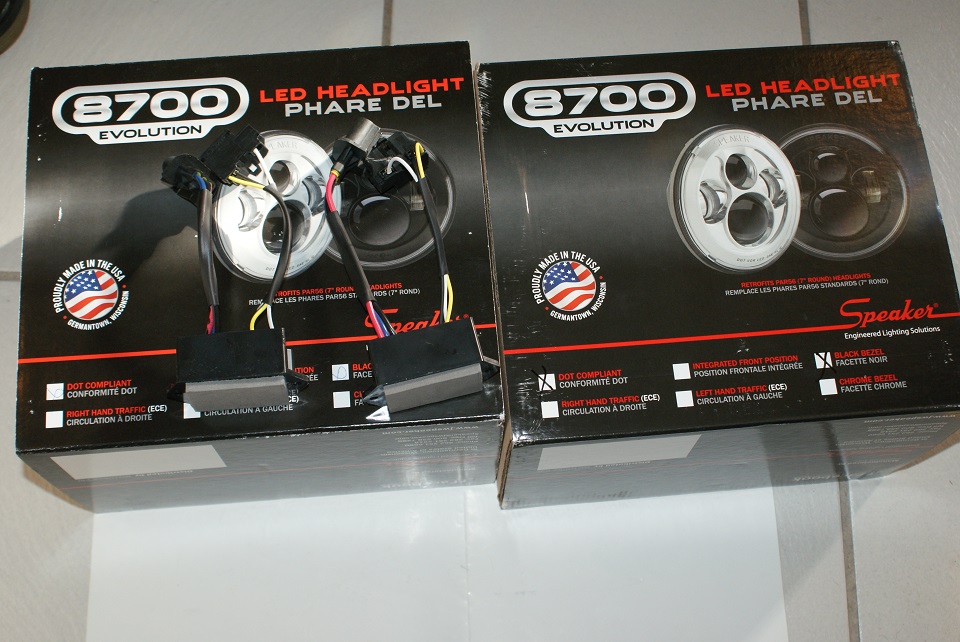

Hello All,
I did this write up a while ago and another member asked me to post it.
So here goes

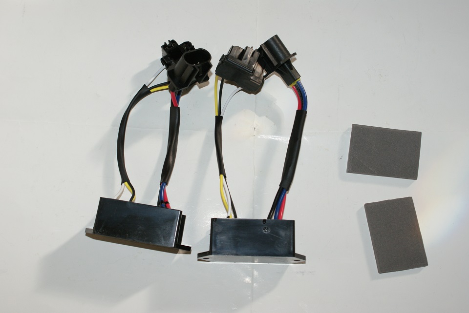

First you need the Headlights and the anti flicker harness like so
The little squares next to the harness are like a sticky back anti vibration foam.

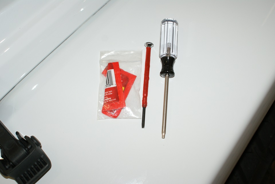

Here are the tools needed
Torx T15 screwdriver
Flat head small electronics type screw driver
Start by popping the hood and remove these push pins

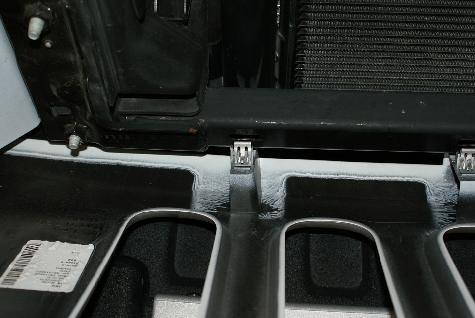

Next you need to remove the grill. its held on by these push pins along the bottom

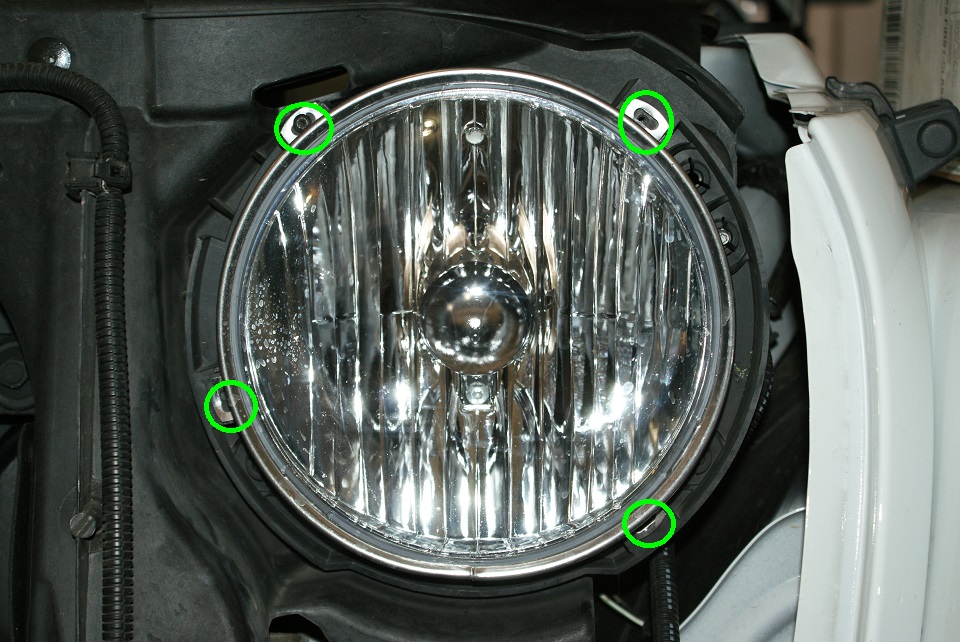

Now that you got the grill off remove the headlight bezel These screws
Remove the old factory so called "headlights"
Install the anti flicker harness be sure that the locking tab is secure.

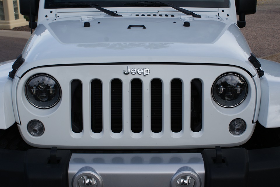

Install the headlight and put everything back together.
Now enjoy your better/safer led headlights
