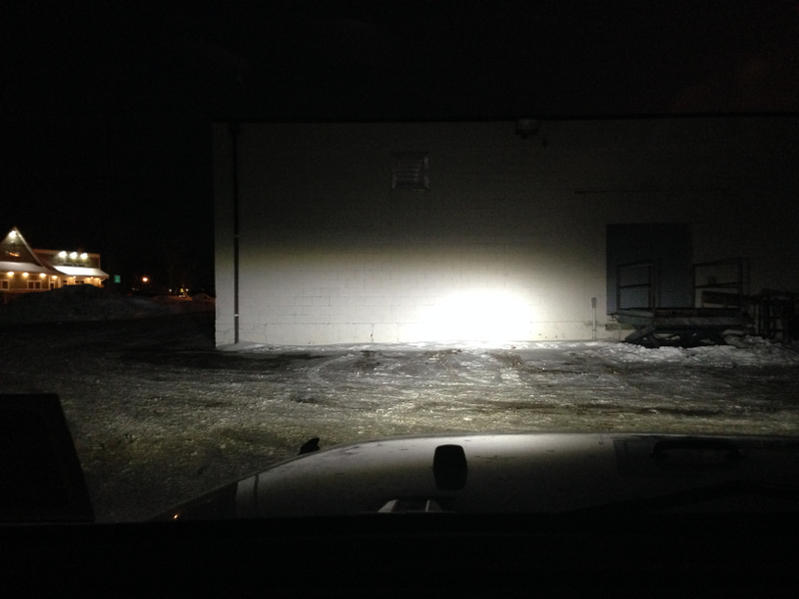

They are not designed for the jk the led points in the wrong direction.
It points at 10 o'clock and 4 o'clock and not 12 and 6 like it should be.
In order to make them work correctly you have to do some modding which is questionable at best, otherwise the light goes towards the oncoming traffic side of the street.
The another problem is that the rubber ring on the housing is to small causing moisture to get into the housing of your light.
If you go through water or even a car wash you can end up with a problem.
Also high beams do light up but they only light up the ground directly in front of you, they do not improve visibility.
And yes, if you use a cb these can cause a lot of noise, there are others out there trying to mod them for that....
The light without modification will be hot directly ahead but haze way over to the left

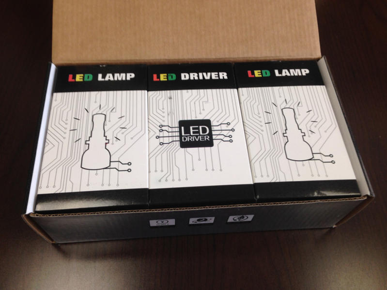

Box shot
just a note, I bought mine directly from china, lifetime led is just relabeling as he stated in a email to a member @ the other forum.
These are only made by one factory and 4 places are reselling them to retailers.
these are the same exact thing as lifetime and currently in the same box.
