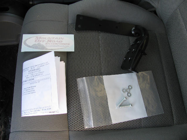

This is what you get in the box from M.O.R.E
Name:	MORE Parts.jpg

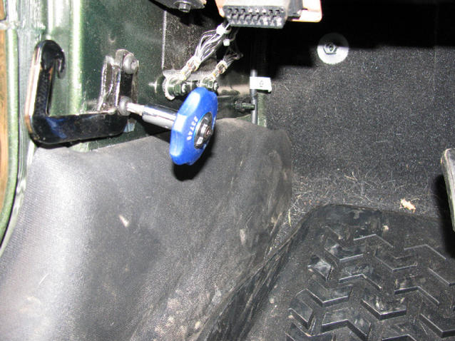

Removing bolts (Torx 30 and 10mm)

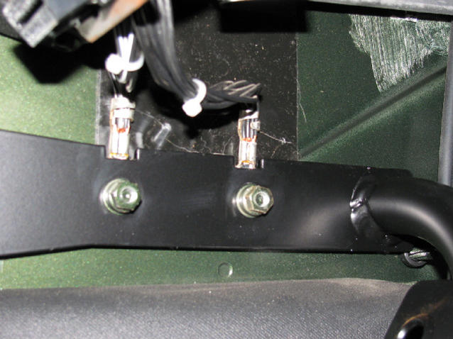

The key is getting the ground wires in the notches as shown here
Name:	Ground WirePosition.jpg

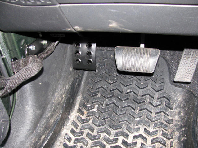

Final look after install
Name:	With Door Strap.jpg
