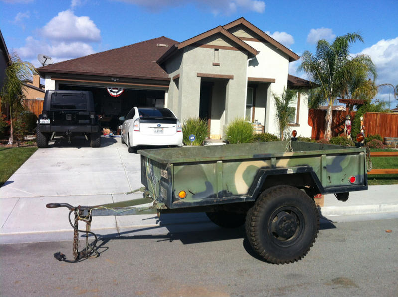

Awesome man you're trailers look great! Good inspiration! How did that 105 on the left tow behind ur jk???? I'm planning in getting to work in the trailer on sat and sun and going to try the wiring and lights suggestions you made. I saw the 2 peice hitch you talked about and considered it. I may still go back and get it. My pintle hitch was $89 and the one you got was about $80 each peice. I didn't think the trailer was as talk as it is, I may end up getting that 2 peice and putting it on the highest setting to get it to sit level. I was a little concerned that a 2 peice Would just add more weak points to fail or come loose with the pintle plate bolting to the receiver, then the hitch.
I just took off my trektop and am thinking ill put it back on and make a canvas cover on the trailer that slants back to match it too. Would look pretty cool. Once again, awesome job on ur trailer

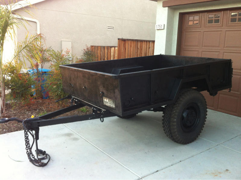

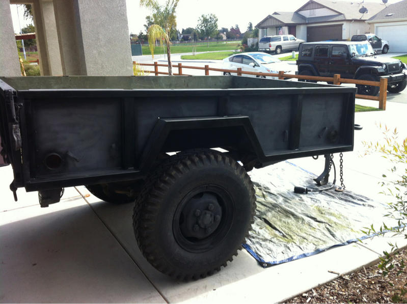

Update: got a little time on Saturday to pressure wash the trailer, sand and prime. I painted the entire underneath with black rustoleum and the exterior sides and frame with it as well. Couldn't stop there and I was on a run so I got the herculiner Bedliner kit and did the interior bed. Standing back after and looking at the trailer, I was glad it was all black but the textures varied from different paints over the years and just some minor waves on the siding with the black paint. So I ended up bed lining the whole damn exterior of the trailer as well. Lookin pretty tough at this point but could still probably use one more coat of Bedliner to make me happy.
Finished in about 4 hours and came inside to a 8 mo pregnant wife that was not happy at all. I guess I told her it would only take me an hour...
Next step- wiring and lights, another coat of Bedliner, getting it plated at DMV

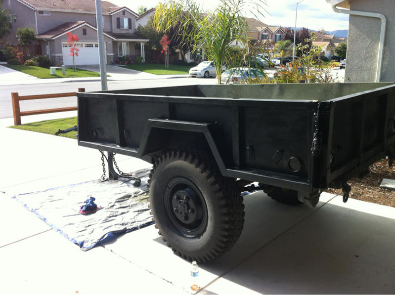

Question for those of you with the pintle hitch. Can I flip the lunette ring bolt so that it will lift the tongue and level out the trailer a bit? ( Lunette bolt angles down to tongue instead of up?) last pic of lunettes explains

Yes, flip the lunette and it will raise the trailer a good 4 inches or so. I did the very same thing with mine. I took mine to the tire shop sown the street since I didn't have a socket big enough. The nut was like a 40mm! They didn't even charge me so I just tipped the guy who busted it loose and flipped it.
I agree with some of the other posts; dont cut the trailer wire spend the extra cash to replace it, its the most heavy duty spool you will find and the only way you should get rid of the pintle hitch is if you are going to switch it over to a max coupler hitch that is silent due to the poly pushing in the joint.
