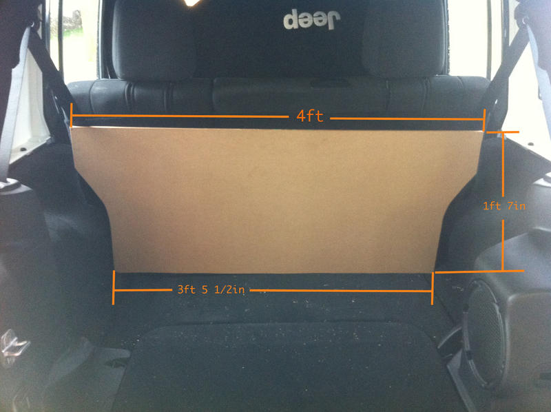

First step was to cut the uprights. I have the stock Subwoofer in the back of mine so I had to do some extra cutting. I included both sets of dimensions in the same photo.

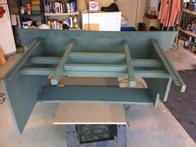

I attached each of the sections using the angle iron and bolts. I wanted the whole thing to be able to break down if I ever hit the Powerball and actually bought a Tuffy Security Box.
After attaching both uprights with the base and 1X1 cross member I did the first test fit (of at least 30!!!!)
Here is a shot of the cut out around the Sub.
Next I cut the back out with yet another few test fits.

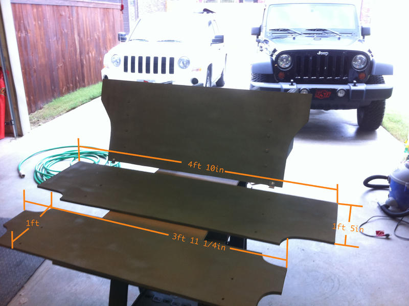

After cutting the two deck pieces I realized I need more support so I added them and then shot it with primer.
Here is a shot of the top pieces with a few measurements. I said before I had the guys at Lowes precut the 59" section. The edge to edge width of the tub is 59" so after a trim on both sides the deck fits snug.
