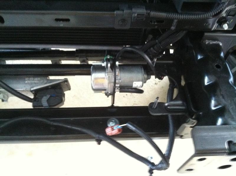

Not sure what the pump is that they put behind the bumper on the new 2012 but it needs to be moved to put a new bumper on. I bought the relocation bracket from LOD and put the mid width bumper on with a Recon winch yesterday. I am not sure if these pictures are on here yet, but thought folks with the 12s would be interested to see what the bracket looks like.
Here is the pump after it is relocated:
I also had to cut the original bracket shorter to fit the winch in (the small arm with the screw post mount from the original location)
Here is the finished product:

It is a vaccum pump

Great write up and pics. Too high for my RR bumper that's sitting on the garage floor waiting for the Orfab kit to arrive.
