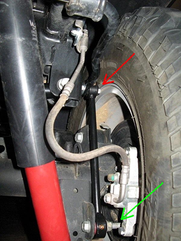

Here’s where you can see the clearance problem that occurs when mounting the sway bar links on the outside. The distance from the head of the nut on the top of the link to the wheel is about 3/8”. I felt that wasn’t good enough so I opted for spacers (as a side note TeraFlex recommends spacers or wheels with the correct spacing too):

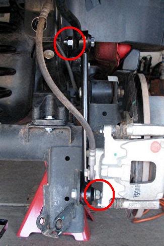

Where was the clearance issue - red or green arrow?
Name:	Sway Bar Link 2.JPG
Noticed the nut position was different between top and bottom of the rear sway bar link. Was that intentional/beneficial?

Originally Posted by shadowpro-jk
PUT THE NUT ON THE INSIDE OF THE FRAME!!!! saves you trouble later.
Top and bottom, and for both front and rear links?

JK-Rubi - it's the Red arrow bolt that you have to worry about. The stock links are shorter so they fall lower (inside of the wheel) so there’s no chance of rubbing. With the longer links they fall higher and can rub. I didn’t take a stock picture with the wheels still on, but if you go out and look at your links I’m sure you’ll see what I mean.
Yeah, the nuts are supposed to be reversed (they are in the stock position). The picture makes it look like the bottom one could hit something, but there’ no way it will. Here’s a before (stock) picture I took before I did any work:

Yeah red arrow. Do it the exact way that Joe has it in his picture or your gunna get rubbing or atleast i did with my stock x wheels.
