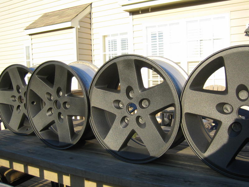

I've painted my Rubicon Rims black with Dupli-color truck bed liner. I like the textered look. My question is do I clear coat over it? and if so, how many coats?

There are some good write-ups on this. Basically clean, sand, clean, prime and then spray on liner. Challenge was getting some bubbles. Over all I really like the look. Time for some new rubber!
Went back and did one more coat for a total of 3 and found out the bubbles were caused by my finger pushing the button on the spray can. All blemishes are gone and they look great! We'll see how there last.

I did the samething with a different brand, didn't use clearcoat. Maybe its been a month and still looks great!!

do y'all know the best way for touching up the rims? I've had mine done for a couple months in a matte black finish and they're starting to fade a Tad bit.
<img src="https://www.jk-forum.com/forums/attachment.php?attachmentid=97648"/><img src="https://www.jk-forum.com/forums/attachment.php?attachmentid=97647"/><img src="https://www.jk-forum.com/forums/attachment.php?attachmentid=97646"/>
That looks bad ass!!! Can that be done with the rubber on!
