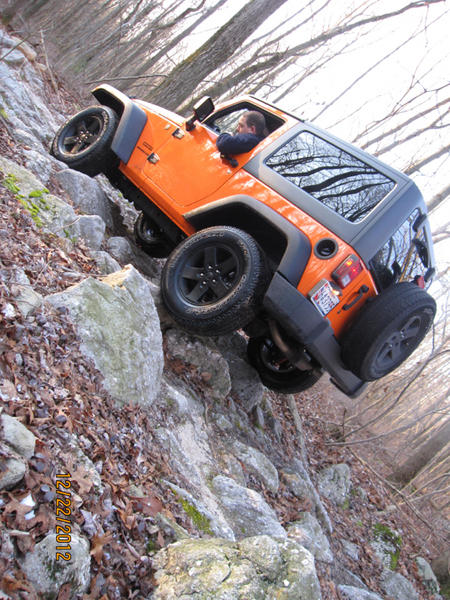

Don't spend hundreds and powder coat wheels. Also plastidip will peel right off from a rock scrape. I used duplicolor low gloss engine enamel ($6 a can) and it still looks great a year later. Only wear spots you see are where rock rash removed metal from the wheel, powder cost would do the same thing. Only difference is I can touch up my wheels for $6 rather than having to redo the whole wheel.
Plasti dip does have it great uses, but I wouldn't use it on wheels, although a lot of people have good results. I may try it on my whole jeep next spring for shits and giggles. I have my front cowl plastidipped and it looks great, still on there
