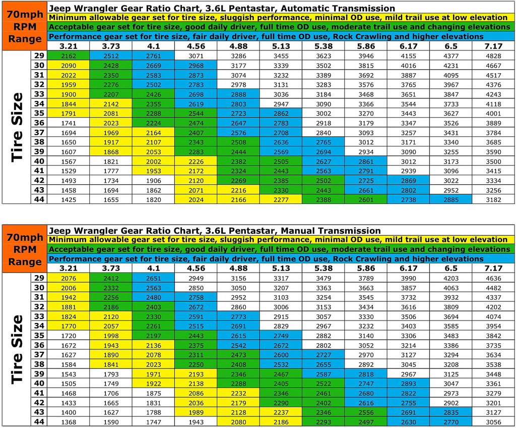

So check this out. I'm sure you guys have seen this. If I go with 4.1, it keeps my RPMs slightly above stock even with 37s. So given the fact that my Jeep is a DD, limited on serious wheelin, tow a 2.5K# boat occassionally and I may or may not even go bigger than the 33"s for my next set with the long term expectation to go to 37s... 4.1 seems to be the way to go... yes?
