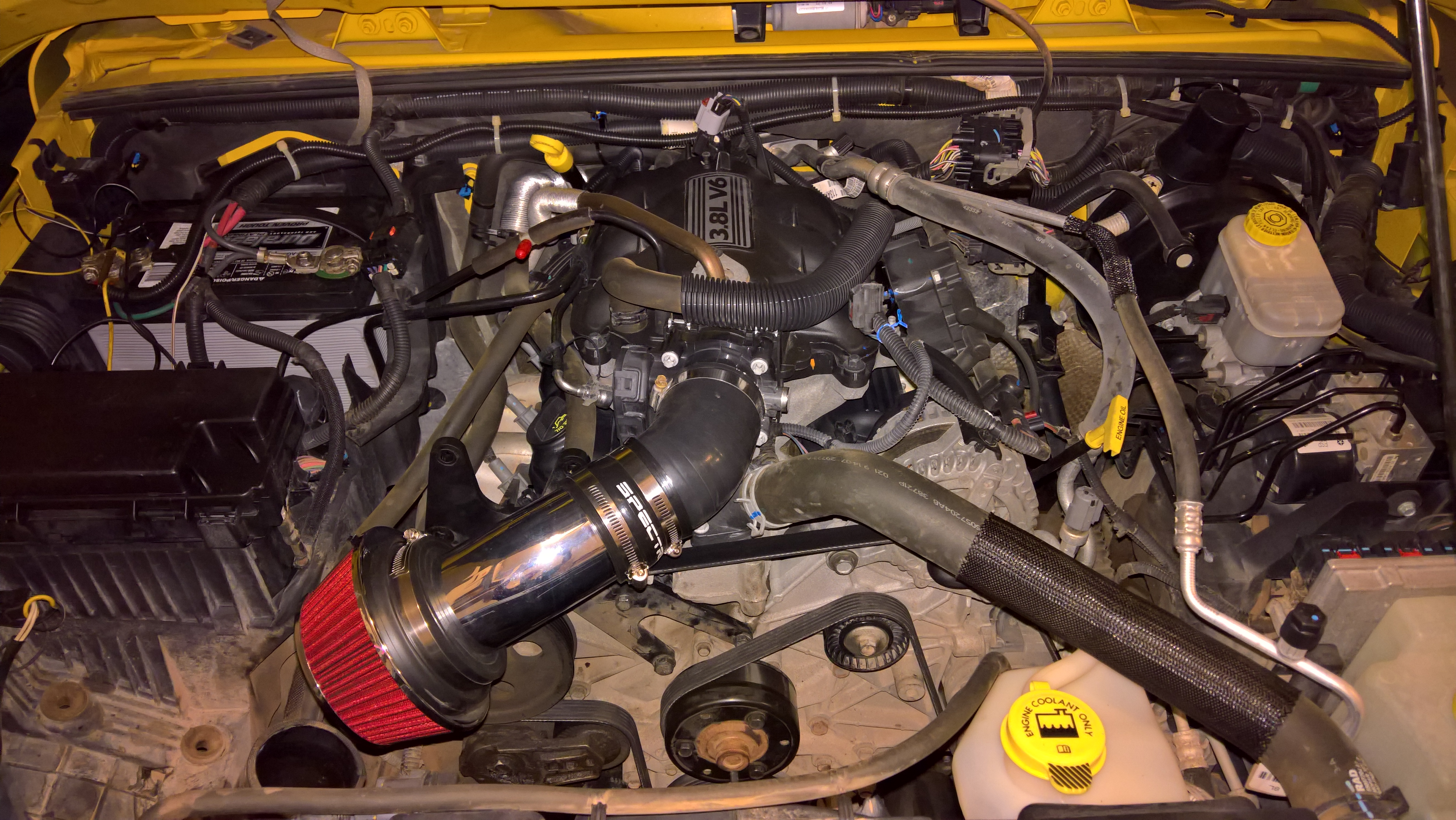

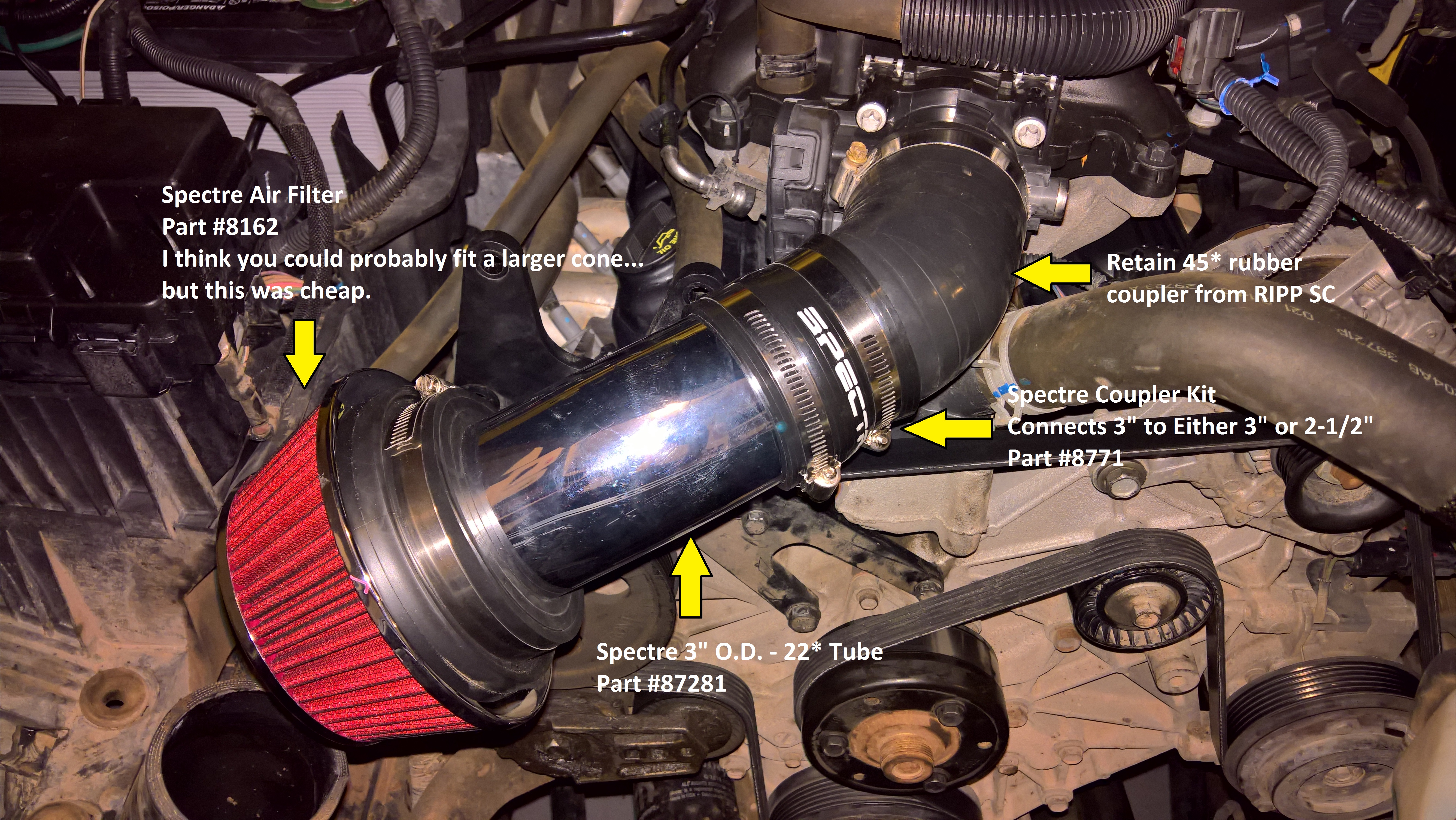

Here's the air filter replacement solution I came up with:
What it looks like now:
