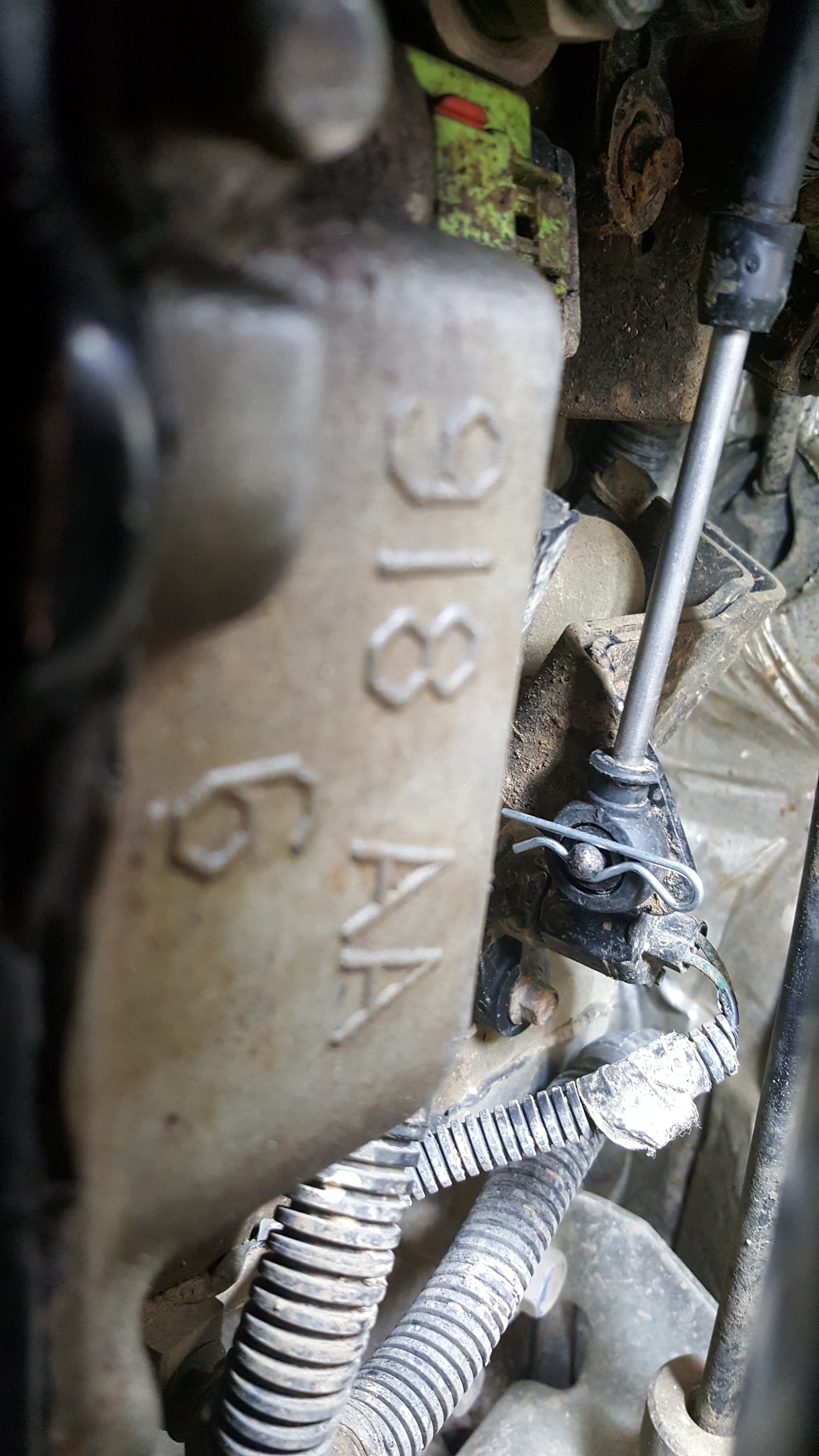

Old Nov 30, 2018 | 07:00 PM
GreenJK07's Avatar
Posts: 3,817
From: Covington, LA
Originally Posted by mstrofpuppets
I got some metal bushings from the hardware store and replaced the plastic ones with that and a small hitch pin. Has worked pretty well so far. The write up is one of the links above.....
I did something very similar. I drilled out the black linkage eye to 1/2" with a step bit. Used a 1/2" screw cap and cut the tip off (used as a new bushing). Then used a cotter pin to hold everything together. There is a groove on the nipple that accepted it perfectly.
ID:	677242   Click image for larger version
