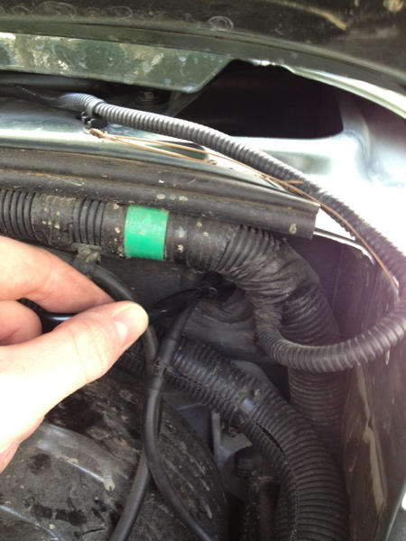

Under the hood, about 2 inches in and 2inches down on the firewall you can see a plug that (I think) the rear window pisser line runs. It pulls out easy to give ya some room. Just poke a slit into it with your pocket knife.

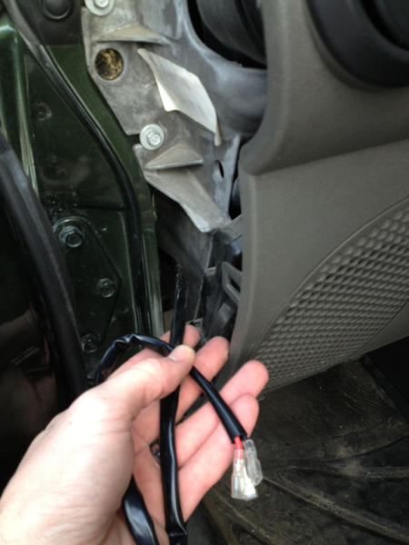

Next, pop off the side dash panel and feed the wire out.

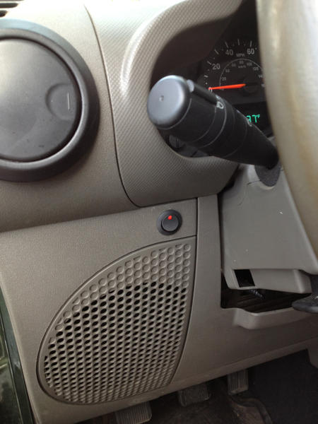

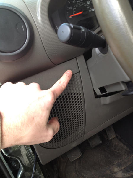

I decided to mount the switch here.
I used a 7/8 step bit and took it down to the second to last step. It was just a hair over 3/4" and fit perfect after some light sanding and cleaning up.

Looks clean huh!???

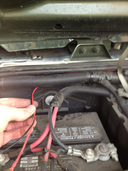

So then I had to figure out the rest of the wiring. I used the existing wire channel on the firewall and ran the pos and neg hook ups over to the battery.

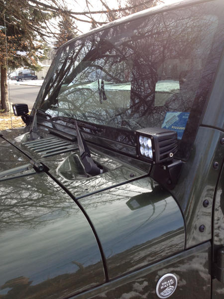

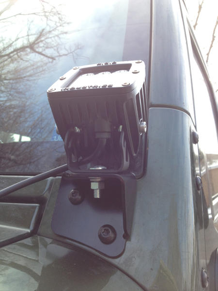

Next I mounted the Poison Spyder brackets... This is simple stupid. Then mounted the lights to them... This is also simple stupid. To make things easy and give me some room I pointed them straight up

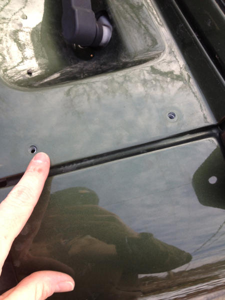

After that, unscrew the star bits on the good cowl right here. (Removing the plastic cover over the wipers gives just enough room for the next step)

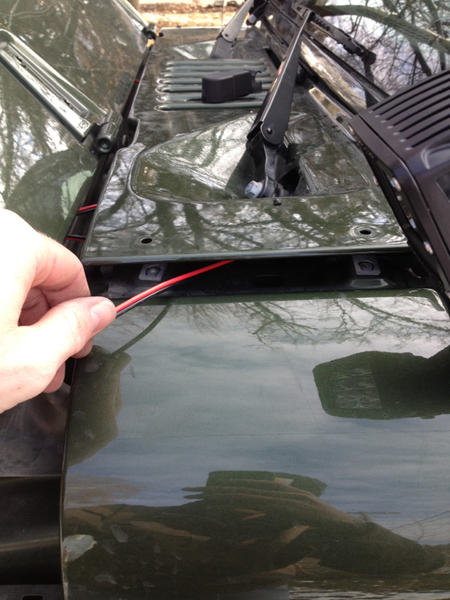

Don't lose these.... It's about a buck eighty if ya do. Pull up the cowl and run the wire to the light plug.

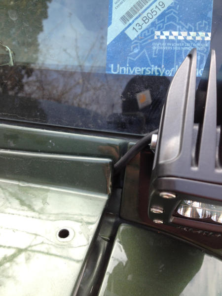

Tuck it all in! There is just enough room in the corner for the thickness of the wire.
