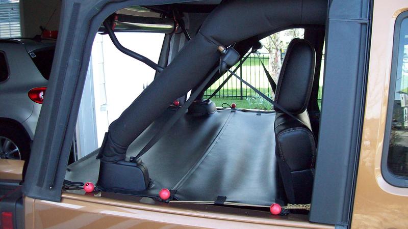

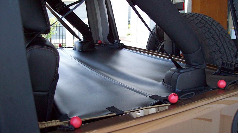

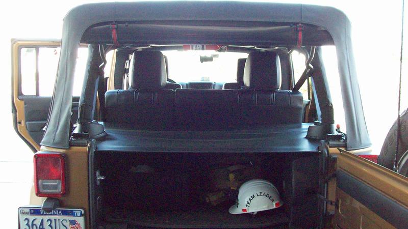

Since I've had my current soft-top JKU, I've been concerned about keeping anything visible inside the cargo area since it's as easy as undoing a zipper and some Velcro, or worse yet, slicing open the back or a side window to get at it. I looked for tonneau-type soft covers and all I found used the same channel to clip into as the soft-top. That rules out using them when the top is on! A few years ago I set out to design my own cover and after playing with it off & on (OK, more off than on), I came up with a cover that would meet all my specifics; it could be laced in from the existing holes along the side rails and rolled up against the seat backs when the cargo area was needed, was adjustable around the roll bar, and would be supported to minimize sag. The pictures are of the final product.

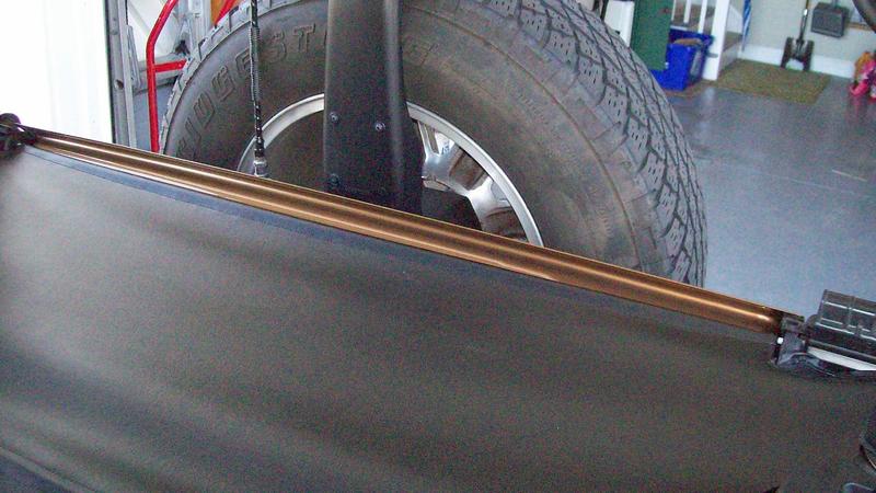

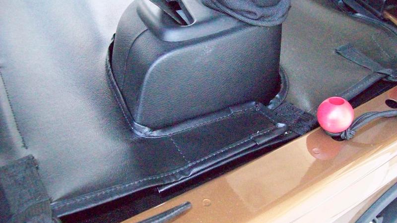

I used marine-grade naugahyde vinyl, had 6-inch nylon straps folded over and stitched in at the anchor points - leaving about an inch unstitched for the bungee or paracord, allowed for about a 3-inch overlap at the rollbars with 2-inches of Velcro, three 1-inch wide sleeves sewn in at the front (against the seat backs), in the middle, and against the tailgate, I then used 1/4-inch fiberglas rod (bicycle safety flags) and attached 6-gage zinc-coated copper wire lugs to the ends and shrink-wrapped them for the front and middle supports (the flat end of the lugs sit on top of the side rails) and used rubber grommets on the ends of the support at the tailgate and drilled a 1/2-inch hole on both sides for the rod end & grommet.
