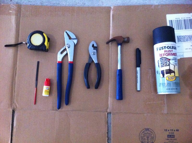

What you will need:
-Tape measure
-Vice grips
-Pliers
-Small hammer (regular will do, but will be more difficult)
-Hack saw
-File
-Sharpy
-Super glue
-Paint (optional)
-And your antenna

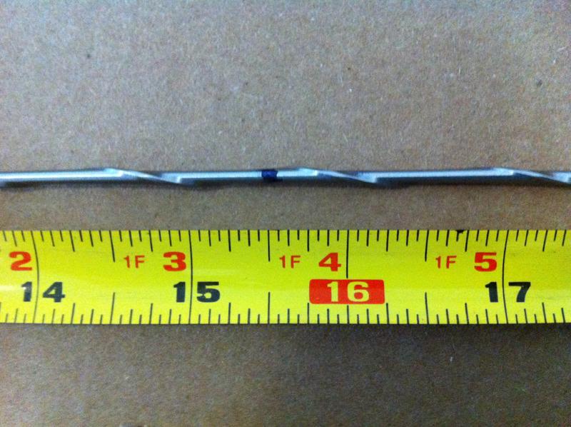

Step 1:
-Measure the antenna and mark the spot with the sharpy of where you want to make your cut. I chose to do 15 1/2".

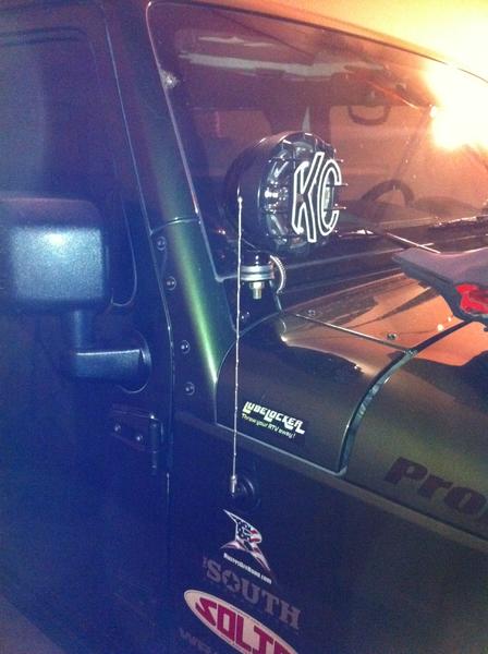

Thumbs up The Finshed Product:
Here is the finished product:
