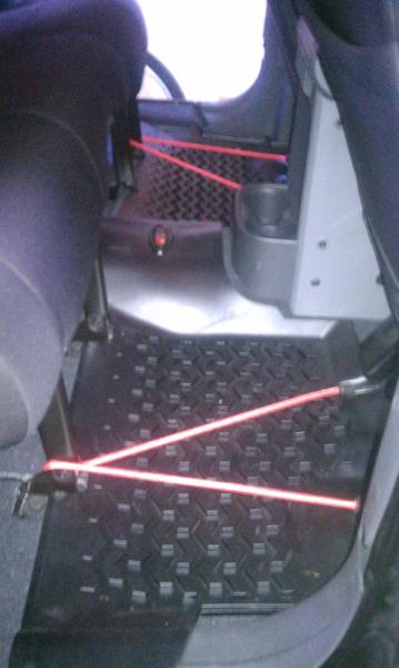

So, on to my question: Any tips for securing carpet down? I already experienced a rear floor mat issue, fixed temporarily with bungee cords (see pic below). I'd like to get the tub bed-lined but that will have to wait for a while...

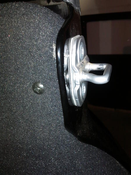

I've had this problem as well, but took care of it with two 1/4-20 bolts. On my 2008 4-door, there's a 6mm hole on the inside wall, just behind each rear door latch. I drilled a hole through the carpet over these holes, and shoved/screwed the bolts in (it was a tight fit, but widening the holes was not necessary in my case). I secured each bolt with a locking washer and nut, then tucked the top corner of the carpet back in place. That location was the weakest link - once a strong freeway gale pulled it loose, the rest of the carpet would inflate out of its seams. With those two bolts in place, it's not going anywhere!

That's a good idea! I am contemplating lining the tub, researching it and saving up $.

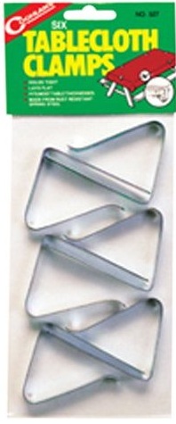

I found an easier way to secure my rear floor mats (I'll post a pic later when I get home).
I secured the rear floor mats to the seat mount brackets with a couple of picnic table cloth clips (the kind you find in the camping section). It is more concealed than that the bungee cord nonsense...

Default Cheap fix to keep rear floor mats secure
Old:
Attachment 191914
New:
Name:	Tablecloth clamps.jpg
Cheap and easy, they hold really well.
I will eventually pull the carpet out and line the tub.

As a followup to my 1/4-20 bolt fix: after about 6 months, one of the sides came loose, with the carpet hole stretching around the securing bolt head. Adding a washer in between the two has kept that from recurring.
