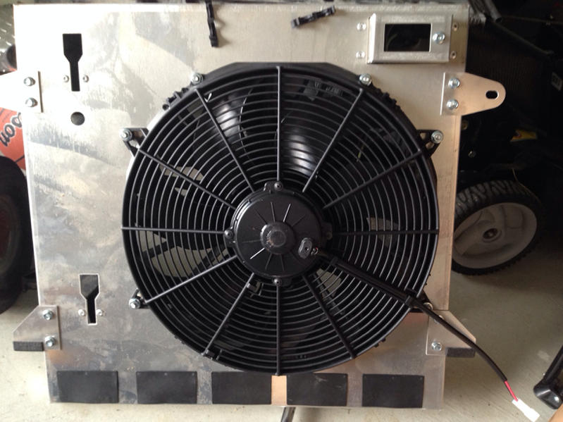

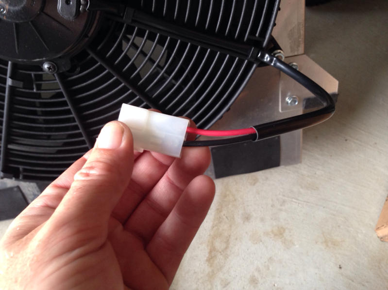

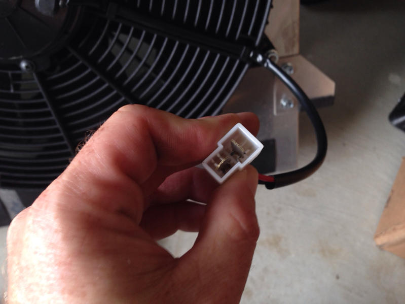

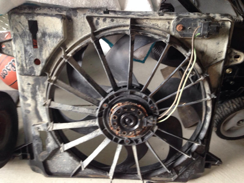

So I got the Spal setup from universal. How are the wiring connections done. The connector provided obviously is not designed to fit the oem connector. See pics. This is probably a noob question but honestly my son (9yrs) and I are trying to accomplish a project together. Thanks for any assistance.

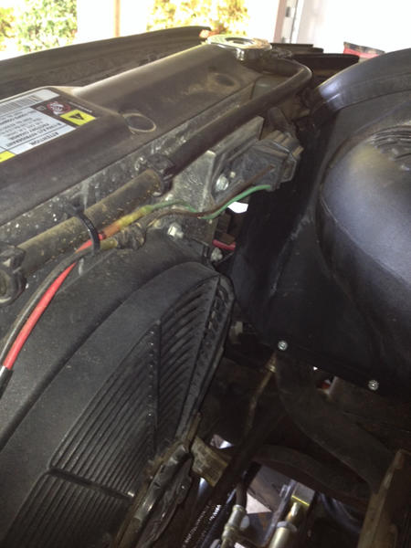

I cut off the spal connector and spliced it into the stock housing so that the jeep could still run the fan normally. The fans worked well like this for over two years.
