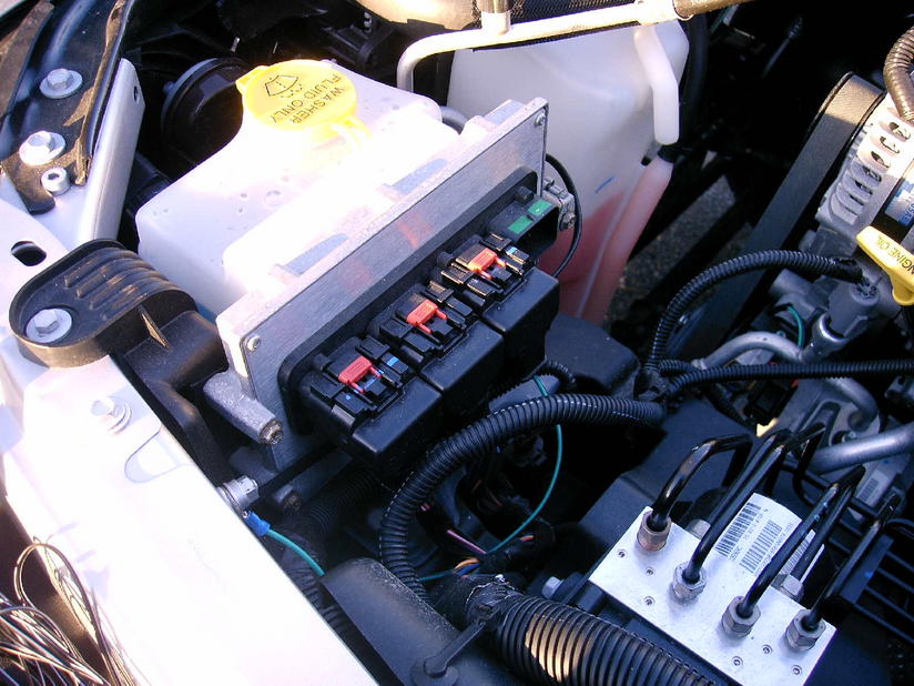

1: Pop hood

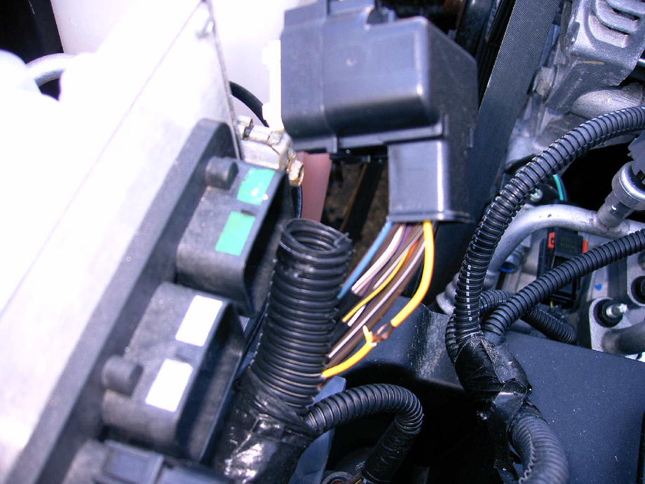

2: Near front driver side headlight you will see a cast aluminum thingy with three black plugs(red slider locks)
3: Assuming you found it, third plug from left closest to radiator(there's one empty location) slide red slider to unlock and pull out.

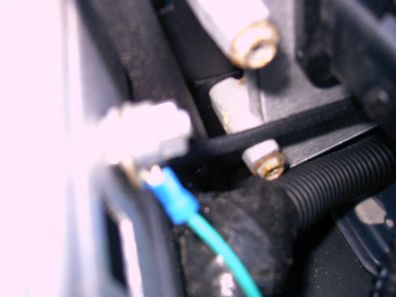

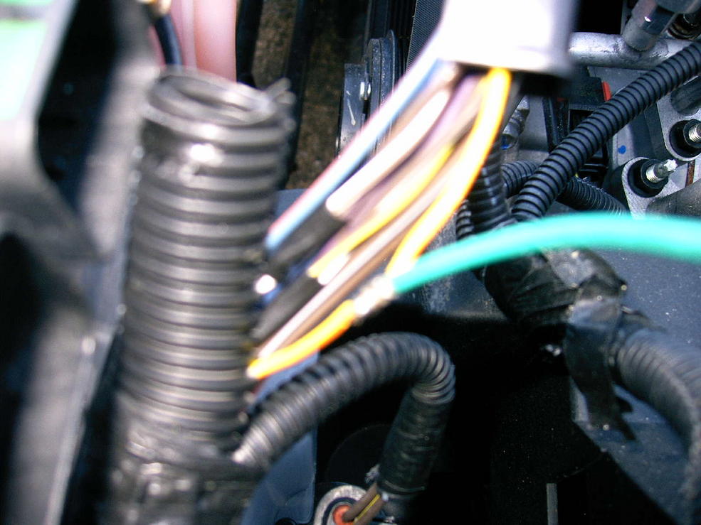

4: Slice open wire loom(carefully) locate solid yellow with red stripe.
5: To test, strip a little of the insulation back, run a scrap wire from yellow/red wire to a good ground. MAKE SURE IT IS IN NEUTRAL! Twist key and let out a sigh of relief, it starts with now clutch.
6: Assuming you're not pinned under your jeep. Shut engine down.
7: What I did was to poke a hole through center of exposed copper of yellow/red wire.
8: Then take a 8 to 10" piece of spare wire and strip end.
9: Insert stripped end through hole made in step 7 and twist 'em nice and tight.
10: Solder(optional but prefered) new wire to yellow/red. Wrap with a good quality electrical tape.
11: Other end of 8 to 10" wire crimp a 1/4" ring terminal(optional, I solder the wire in end once I crimp)
12: Locate ground lug near driver fender, loosen nut with a 10mm open end or socket and secure ring terminal.
