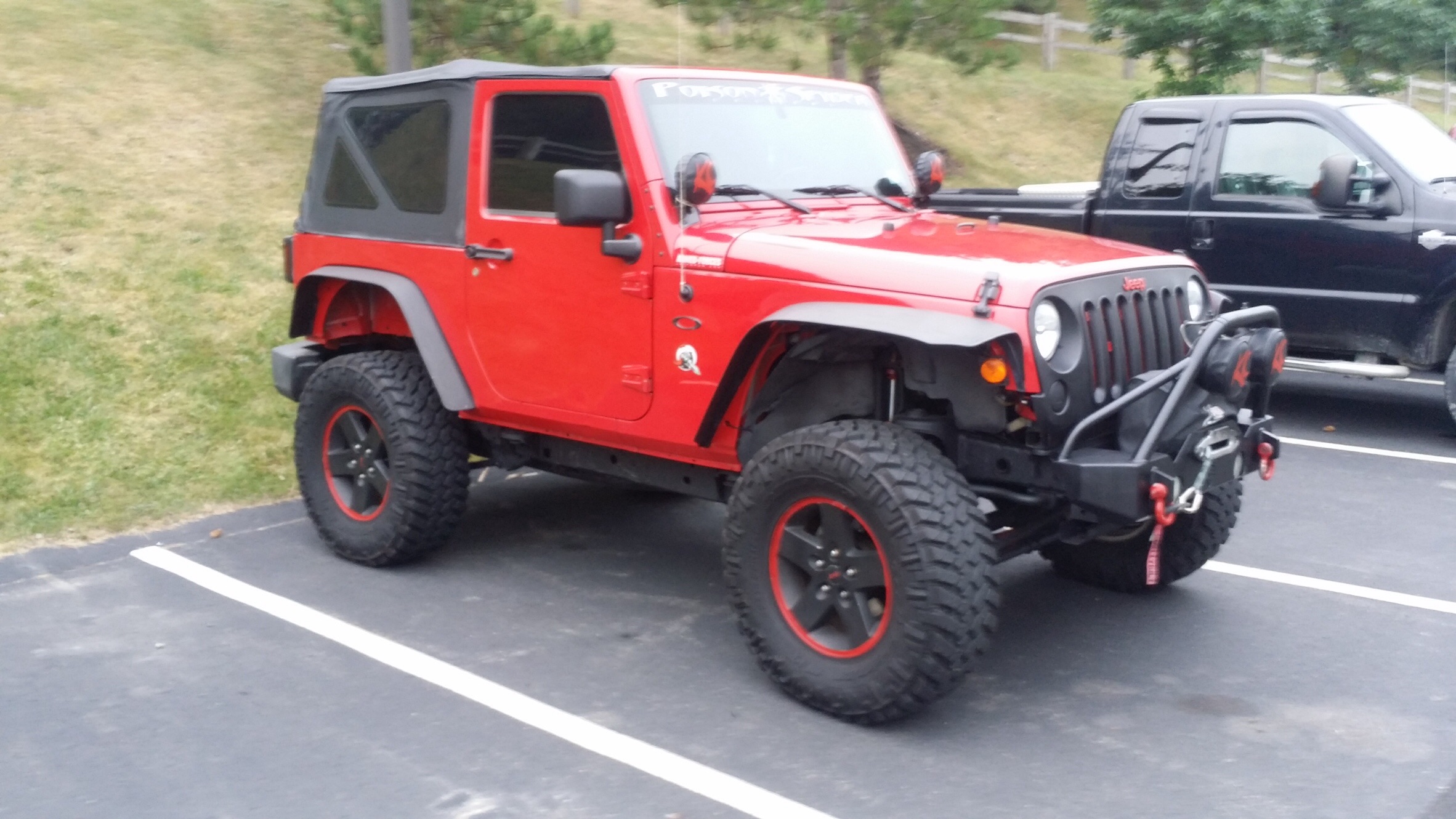

Before:

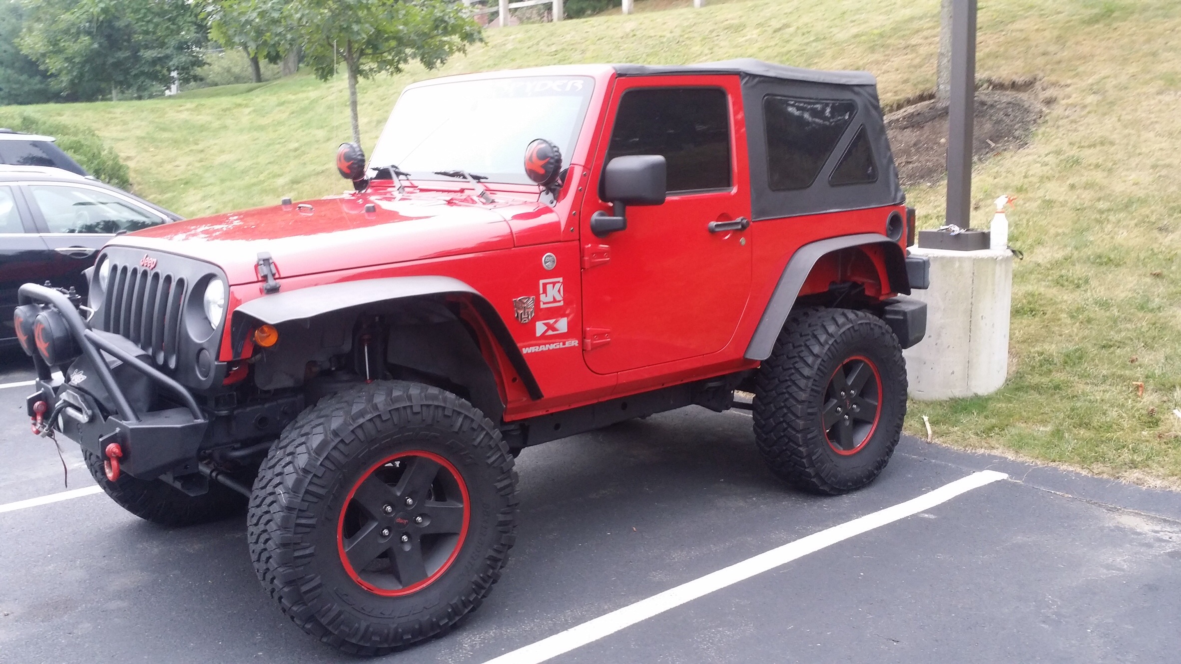

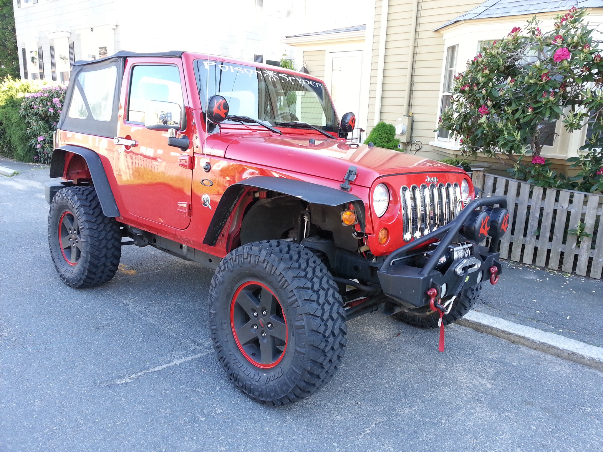

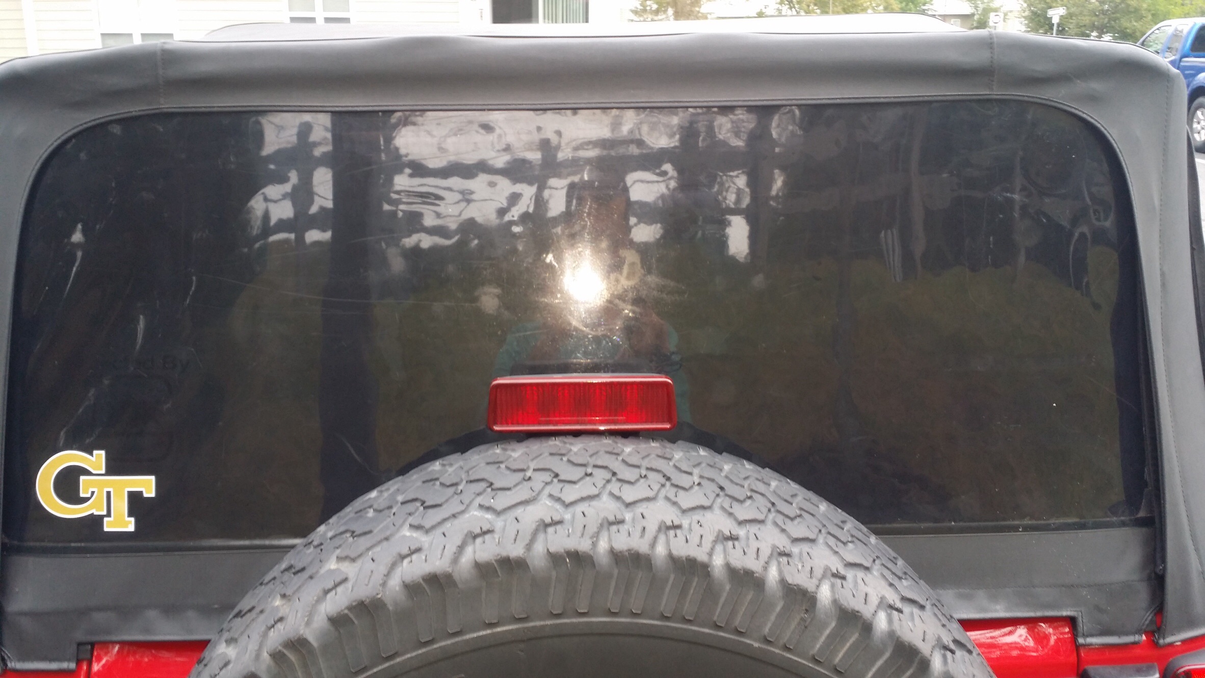

After:
ID:	622423Click image for larger version
ID:	622424Click image for larger version
