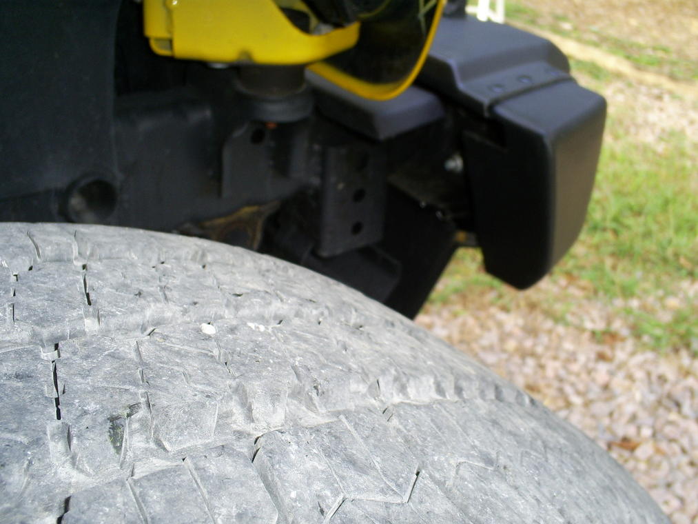

Old Apr 19, 2009 | 06:14 PM
  #38
TINMAN080's Avatar
Posts: 2,472
From: Virginia Woods
Default An inside picture
Not too clear... Sorry. It actually looks pretty finished.
Name:	stubbie bumper mod 016.jpg
