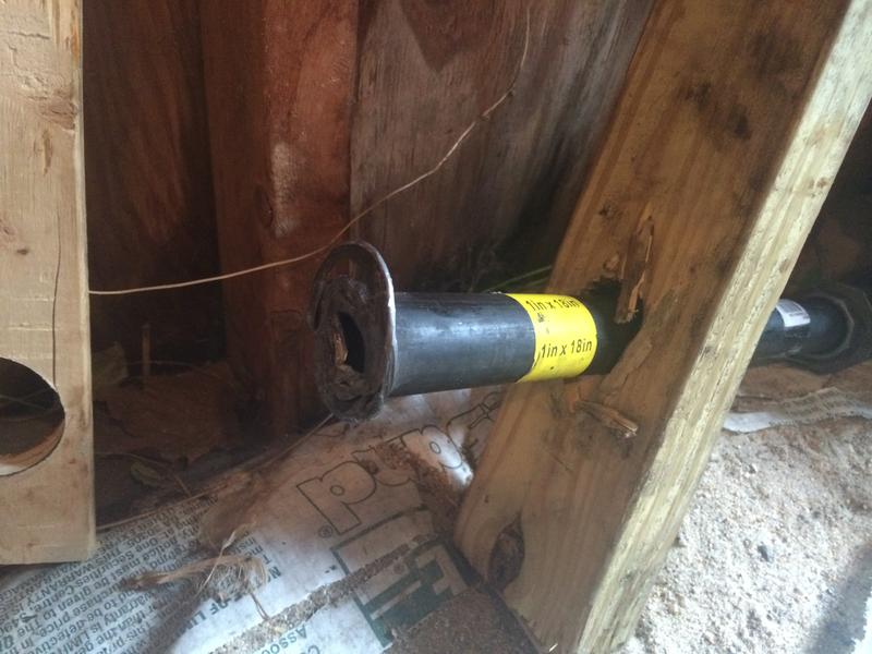

Here is a pic of the tool I made:
Parts List: 18 inch long 1" black steel pluming pipe with threaded ends, 1" union joint, and a 1" steel floor flange
How to: This tool is super easy to make with parts from Home depot or Lowes - you will notice that the 1" union joint on the buisness end does not quite fit into the axle sleeve - you will need to grind the end so that it is round and then it fits perfect.... Do not use the 3/4 pipe joint setup as some have, it is not even closse to strong enough and I broke one in 3 strikes....

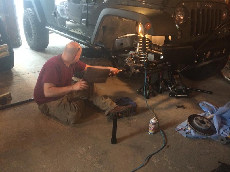

-now place the paint roller cover over your stick, shovel handle, dowel, whatever you decided to use and coat the roller in PB blaster
-in and out with the roller then repeat with mineral spirits, again with blaster, and again with spirits
