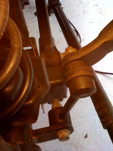

The reason I ask about using the bottom bolt in the top of the link is that my 10' has pressed in pieces similar to the rear links. Here is a shot;
When I use the quick disconnect for the bottom of the new link what else would I use to attach the top of the new link to the sway bar?
Old Jul 27, 2011 | 06:02 AM
  #60
wxjeep's Avatar
Joined: Feb 2010
Posts: 178
From: Ft. Drum, NY
Yes, you use the original bottom bolts. I had to cut some threads off of the originals to prevent rubbing.
